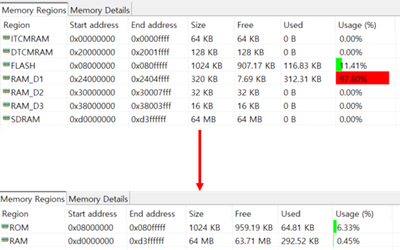

All internal RAM has been used to implement the current application.
Additional feature implementation requests require variable allocation and access to external RAM.
I reviewed the STM32CubeH7 example and applied it to my project, but encountered a HardFault Handler.

Build Analyzer - Memory Regions

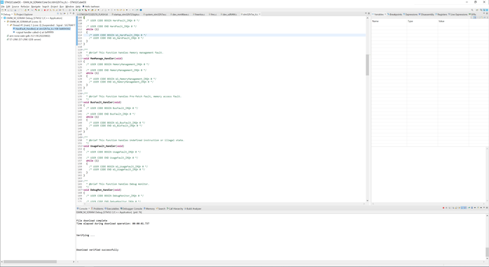

HardFault_Handler
Debug Message
Starting server with the following options: Waiting for debugger connection... Log output file: C:\Users\thyu\AppData\Local\Temp\STM32CubeProgrammer_a05560.log Memory Programming ... Erasing memory corresponding to segment 0: File download complete
Download verified successfully

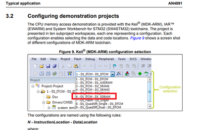

Also there is an example how to locate the global variables in the external SDRAM in x-cube-perf-h7 related to the AN4891 STM32H72x, STM32H73x, and single-core STM32H74x/75x
system architecture and performance
Look at the project config 6 where the code is executed in ITCM and all variables are located in SDRAM:
Advice: before starting to relocate your variables in SDRAM, you need to do some read/write tests to validate that the SDRAM access is correct and you don't get any read/write issues.

Your SystemInit() code needs to bring up the clocks, PLLs and SDRAM so code in startup.s can initialize the statics. Doing it in main() is too late.
The HardFault_Handler indicates that the memory you are touching is not functional.
