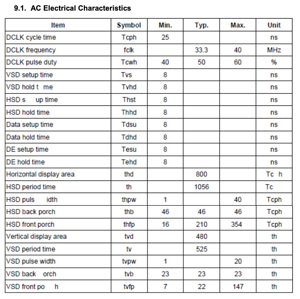

The following is the data on the Porch of my LCD. How to change LTDC's Porch value?
current LCD Clock is 32 Mhz.
#define T080800480_A1TMN_003_HSYNC ((uint16_t)1) /* Horizontal synchronization */
#define T080800480_A1TMN_003_HBP ((uint16_t)46) /* Horizontal back porch */
#define T080800480_A1TMN_003_HFP ((uint16_t)210) /* Horizontal front porch */
#define T080800480_A1TMN_003_VSYNC ((uint16_t)2) /* Vertical synchronization */
#define T080800480_A1TMN_003_VBP ((uint16_t)23) /* Vertical back porch */
#define T080800480_A1TMN_003_VFP ((uint16_t)22) /* Vertical front porch */
hLtdcHandler.Init.HorizontalSync = (T080800480_A1TMN_003_HSYNC - 1);
hLtdcHandler.Init.VerticalSync = (T080800480_A1TMN_003_VSYNC - 1);
hLtdcHandler.Init.AccumulatedHBP = (T080800480_A1TMN_003_HSYNC + T080800480_A1TMN_003_HBP - 1);
hLtdcHandler.Init.AccumulatedVBP = (T080800480_A1TMN_003_VSYNC + T080800480_A1TMN_003_VBP - 1);
hLtdcHandler.Init.AccumulatedActiveH = (T080800480_A1TMN_003_HEIGHT + T080800480_A1TMN_003_VSYNC + T080800480_A1TMN_003_VBP - 1);
hLtdcHandler.Init.AccumulatedActiveW = (T080800480_A1TMN_003_WIDTH + T080800480_A1TMN_003_HSYNC + T080800480_A1TMN_003_HBP - 1);
hLtdcHandler.Init.TotalHeigh = (T080800480_A1TMN_003_HEIGHT + T080800480_A1TMN_003_VSYNC + T080800480_A1TMN_003_VBP + T080800480_A1TMN_003_VFP - 1);
hLtdcHandler.Init.TotalWidth = (T080800480_A1TMN_003_WIDTH + T080800480_A1TMN_003_HSYNC + T080800480_A1TMN_003_HBP + T080800480_A1TMN_003_HFP - 1);

"The cycle of symptoms" changed to what?
Looks like your configuration is according to spec - Have you tried changing T080800480_A1TMN_003_VSYNC within that allowed range (1-20) - currently 2.
