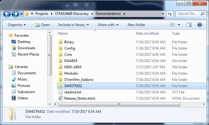

In the CubeF4 package there is a complete code of demo application for STM32F469 Disco kit, which controls the LCD. You can find it under this path:
...\STM32Cube_FW_F4_V1.16.0\Projects\STM32469I-Discovery\Demonstrations
Among few supported toolchains you can find also a project for AC6 SW4STM32:

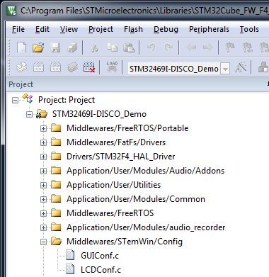

If you open the project, you can navigate through it and find some libraries responsible for LCD, for example LCDConf.c:
I hope this information will be helpful to you.
