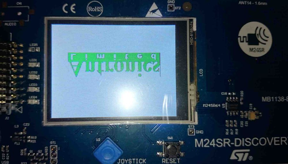

I found this ''
BMP to C image conversion utility'':
http://www.lpcware.com/content/nxpfile/bmp-c-image-conversion-utility
It creates an array of 16-bit values:
* BMP image data converted from 24bpp
* to RGB565
#define COLOR_BPP 16
#define COLOR_STORAGE_SIZE 2
#define BMPWIDTH 239;
#define BMPHEIGHT 65;
const
unsigned
short
image16[] = {
0xffff, 0xffff, 0xffff, 0xffff, 0xffff, 0xffff, 0xffff, 0xe69a,
0xab6d, 0x9a69, 0xb3ae, 0xeefb, 0xffff, 0xffff, 0xffff, 0xffff,
0xffff, 0xffff, 0xffff, 0xffff, 0xffff, 0xffff, 0xffff, 0xffff,
0xffff, 0xffff, 0xffff, 0xffff, 0xffff, 0xffff, 0xffff, 0xffff,...
I just used a quick regular-expression search & replace to split into bytes:
0xff, 0xff, 0xff, 0xff, 0xff, 0xff, 0xff, 0xff, 0xff, 0xff, 0xff, 0xff, 0xff, 0xff, 0xe6, 0x9a,
0xab, 0x6d, 0x9a, 0x69, 0xb3, 0xae, 0xee, 0xfb, 0xff, 0xff, 0xff, 0xff, 0xff, 0xff, 0xff, 0xff,
0xff, 0xff, 0xff, 0xff, 0xff, 0xff, 0xff, 0xff, 0xff, 0xff, 0xff, 0xff, 0xff, 0xff, 0xff, 0xff,
The Width & Height values seem to need to b reduced by two each to work with the ST stuff. But I end up with the image appearing ''wrapped'' in the display: 0690X00000603HsQAI.jpg

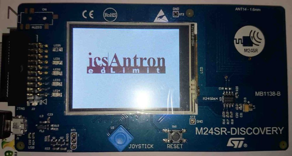

Andrew Neil
Super User
Posted on August 13, 2014 at 19:59
STSW-STM32098
STM32 embedded GUI library (AN3128)
http://www.st.com/web/catalog/tools/FM147/CL1794/SC961/SS1743/PF257934#
Includes a Resource Editor - which can convert a BMP file to a 'C' array.
But the result is upside down (actually, reflected in the horizontal axis).

Andrew Neil
Super User
Posted on August 13, 2014 at 21:21
Yes, that's the one I used - but, as I said, the result is ''upside down'':
But then it's not actually stated that the
M24SR-Discovery is using the same graphics format...

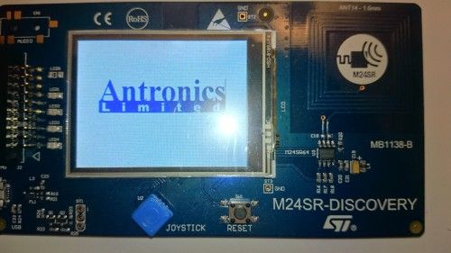

Andrew Neil
Super User
Posted on August 14, 2014 at 20:16
''the result is 'upside down'''
I can fix that by inverting the bitmap before converting it.
Also had to modify the LCD_WriteBMP_FAT() function to get the bytes in the correct order for the right colour - blue, not green:
