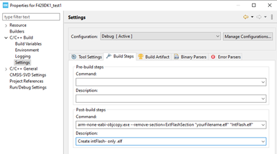

2023-07-04 10:04 AM
Hello
One way is to use arm-none-eabi-objcopy- command to create Elf -file which contains only internal flash, like this:
arm-none-eabi-objcopy.exe --remove-section=ExtFlashSection "yourFilename.elf" "IntFlash.elf"
and place this to the post-build command.
2023-07-04 6:58 PM
It works for us! Thanks @JTP1 !
In our case, we add more "--remove-section" at pos-build command line because we have 3 section mapped on linker file.
Also to this, we create a Build Configuration to help switch between full program memory (internal and external) and only internal memory.
In debug configuration, main tab:
- create a new Debug Configuration
- select the C/C++ Application ELF file (the new one with internal memory)
In debug configuration, debugger tab:
- remove the external loader
