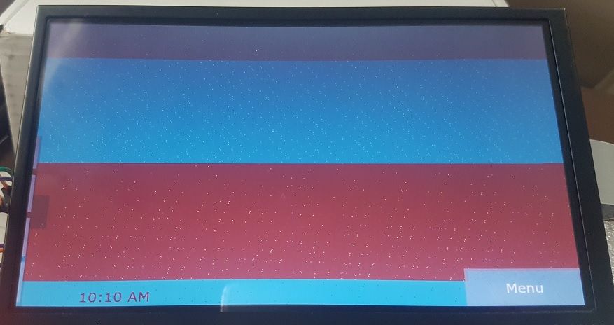

2021-01-03 1:59 AM
I couldn't achieve to display the images and I attached the result.
I can navigate through the pages of GUI coz it displays the buttons like a shadow. I couldn't find out the missing point.
