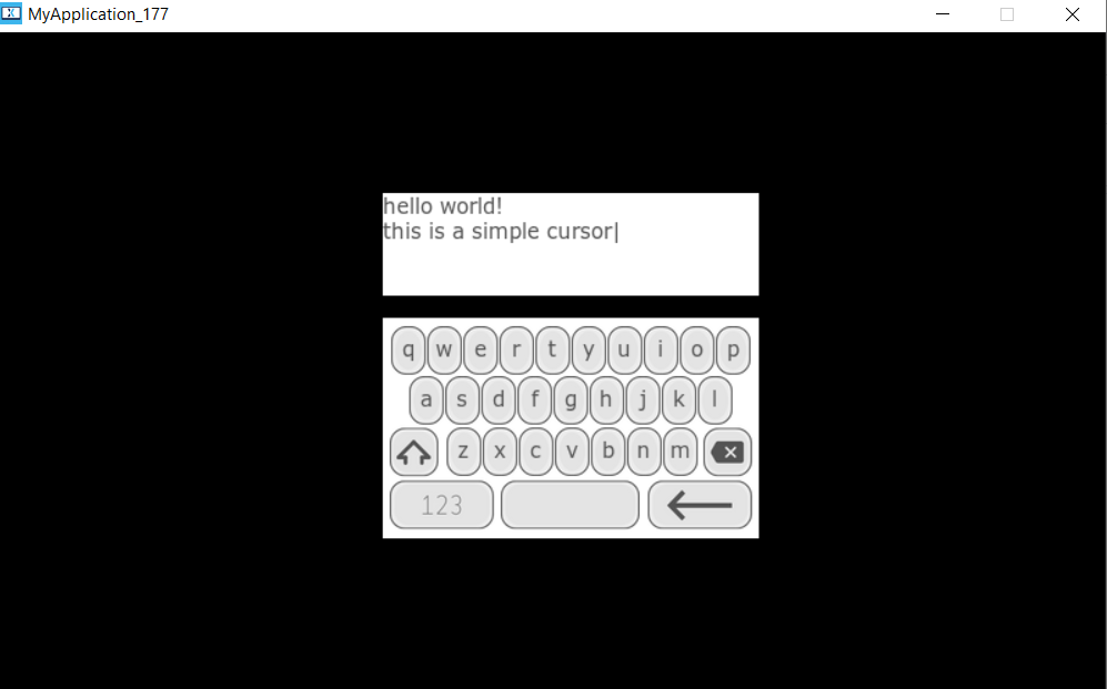

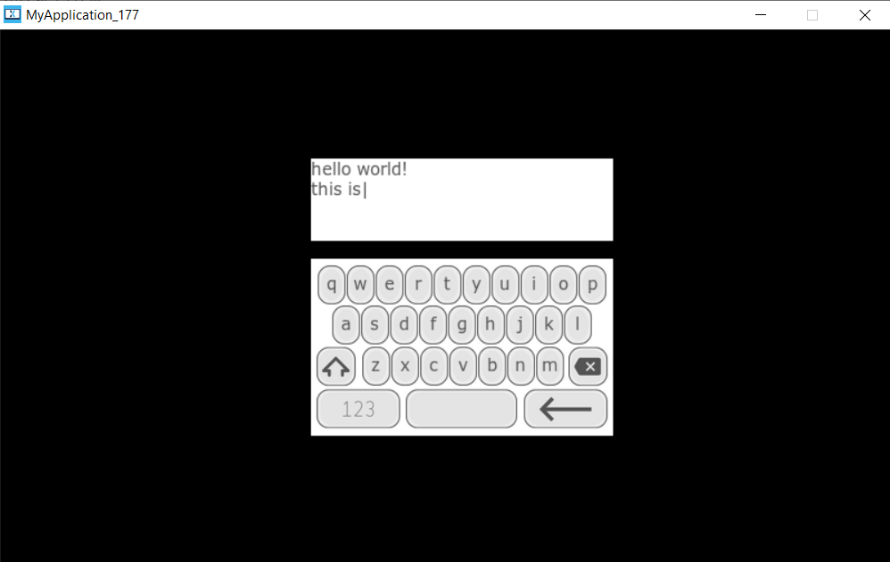

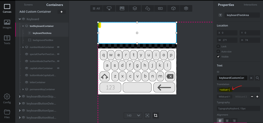

If you just want to add a cursor to your text, I'm going to say to simply use the vertical line symbol ( | ) at the end of you text like this :
I'm using the keyboard widget shared in this post and I only modified the TextArea to add the vertical bar like this :
/Osman
