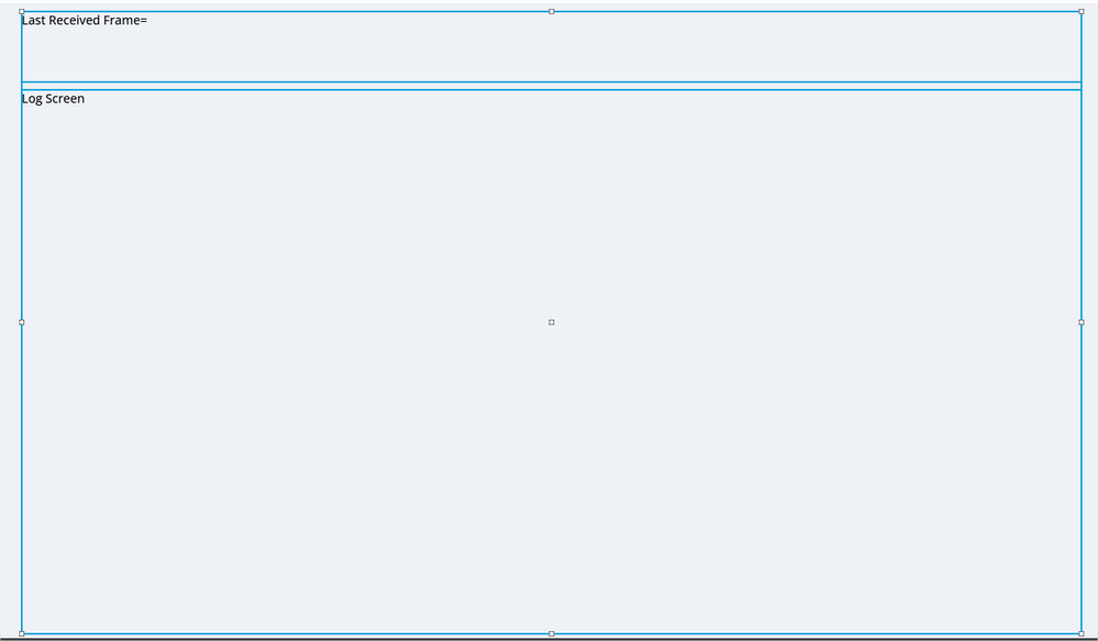

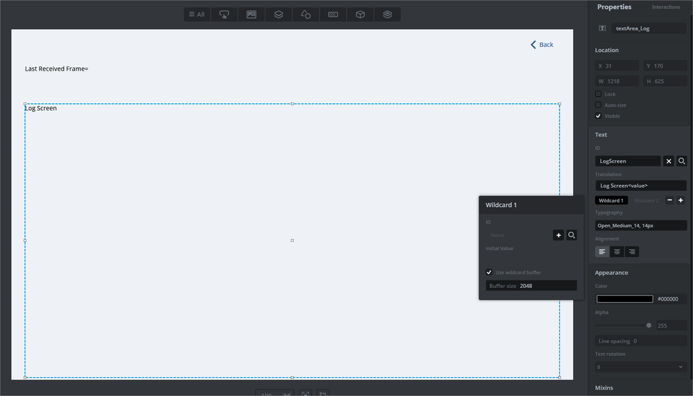

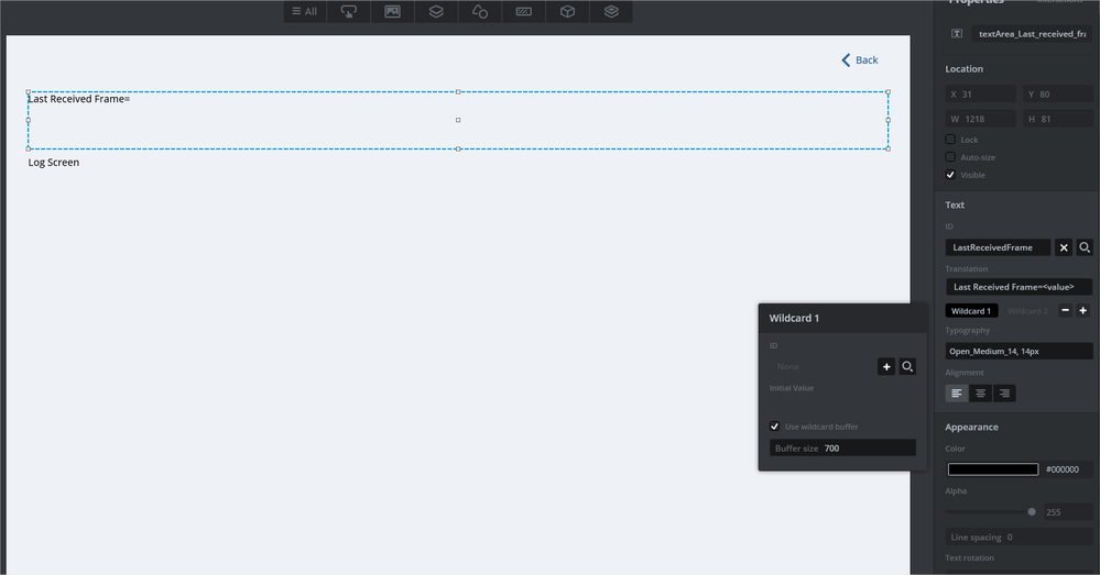

I have a screen with 2 texts zones, one small and one big and the biggest zone flickers when I update it with invalidate. The smallest one has no problem. They do not superpose.

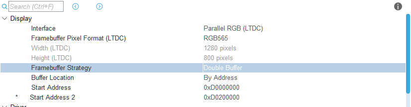

I've managed to remove the flicker by going double buffer but using address 0xD0400000 instead of 0xD0200000.

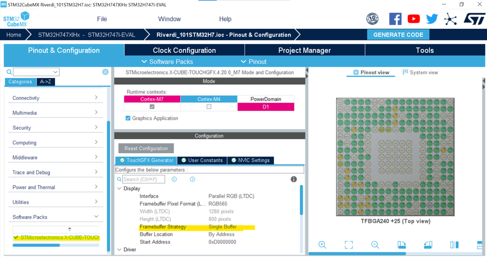

2022-09-22 2:01 AM
Hello Eve,
The framebuffer strategy that MM..1 is talking is about your display configuration; if you open your project ioc file with STM32CubeMX, you can get this information. If it's a single framebuffer strategy, you can try to change it to double instead to prevent your flickering images. I invite you to follow this guide to change the framebuffer strategy.

2022-09-22 4:43 AM
Hello @Osman SOYKURT,
I have tried what you said, but it doesn't change a thing. I've also looked at the screen closer and it seems like the first text flickers too but it's less noticeable.

2022-10-12 2:37 AM
Hello @Osman SOYKURT and @MM..1 ,
Thank you both for the help,
Eve
