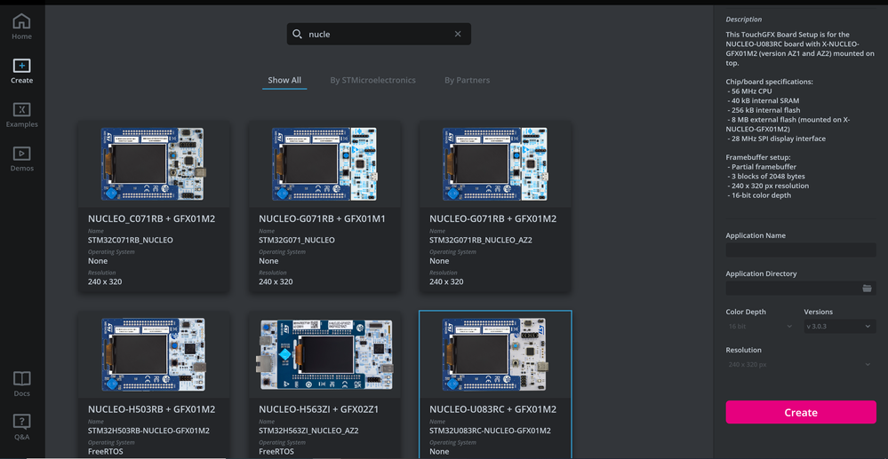

There are plenty of guidance and documentation on how to start your custom project with TouchGFX.
You can start the procedure by following these documents:
There are a number of TouchGFX Board Setups available that use SPI display interface that you can draw inspiration from to implement your project like: NUCLEO-G071RB, NUCLEO-U083RC, and etc.
NUCLEO TBSs

Hello @PhilZalkin ,
Currently, there is no plan to add NUCLEO-H7A3ZI to the TouchGFX Designer. And, you cannot simply change the MCUs in one project to another one since there are numerous configurations that must be handled for each case.

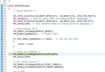

2024-07-23 5:46 AM
2024-07-23 6:24 AM

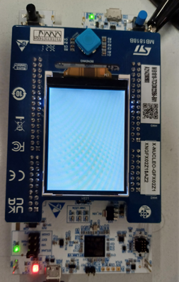

My screen is :

Hello @PhilZalkin ,
Unfortunately, I don't have access to the hardware to test it manually, however, your configuration looks fine (the pinouts for FMC correspond to the MCU schematics and the Display schematics)
Maybe it is better to just focus on showing simple data on the screen by following the guide available here, and afterward, combining it with TouchGFX.
