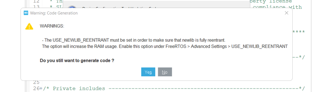

I'm trying to setup STM32F429I with TouchGFX, but during the debug this message appears:
How can I enable it?

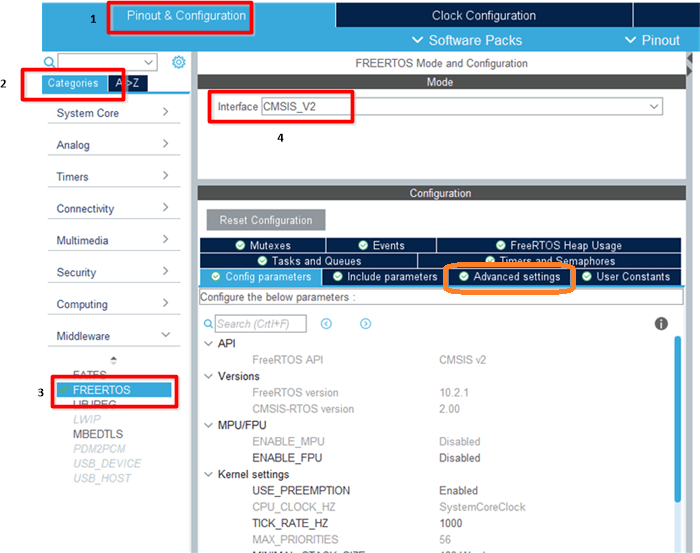

Are there some Advanced Settings for FreeRTOS you can set?
A command line define, or a config file of some sort?

2022-09-15 1:03 PM
Apt to be in the
Pinout & Configuration
Addition Software
Middleware
FreeRTOS
