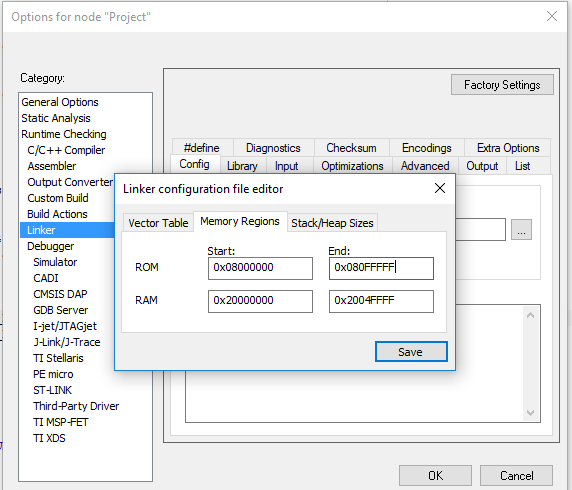

I believe that what I need to do is to change the address space in the below defines in the LCDConf.c source file. I have♯ define GUI_NUM_LAYERS 1
,so I believe that only the ,LCD_LAYER0_FRAME_BUFFER
needs to be changed. But no matter what address I specify it will not work. ,/* From SDRAM */
♯ define LCD_LAYER0_FRAME_BUFFER ((int)0xC0200000),
♯ define LCD_LAYER1_FRAME_BUFFER ((int)0xC0400000)Below is my RAM space setup.
