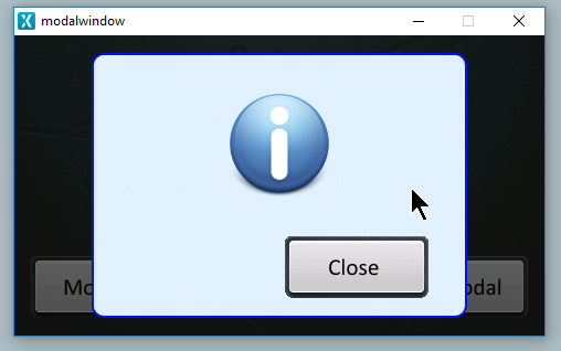

Hi @zzzzz,
Did you check out the ModalWindow Example through the designer yet? The view is alive and well and receiving ticks. You could also close it programatically from the presenter when receiving some message from the backend.
/Martin

Yes we did try modal window. Here is how we try using modal window to solve our problem
button callback handler(or any widget click callback handler)
statement1;
ShowMyModalwindow();//initialize modal window based on statement1, set widget visible and invalidate it.
while(check response from modalwindow);
statement2 ; // statement2 need date from statement1 and response from modalwindow to finish its logic.
The problem is that screen stop redrawing when execute callback handler, then the modal window cannot show up and we cannot click the button on it to quit while loop. We understand polling the response from tick will work. we are porting our project from old GUI to TGFX. We don't want change the logic too much. Is there any way that redraw the screen from the callback handler? Thanks.
