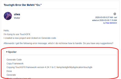

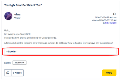

PS:
Why did you put the output log in a 'Spoiler' tag?
2026-03-05 3:02 AM
Where would you put the output log?
