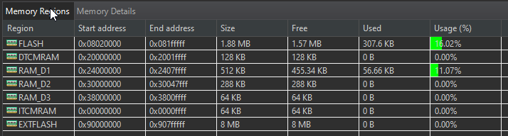

Here are the memory assets when I have the project configured for internal flash...
and here is how the linker script is configured of course..

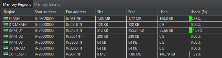

Now I just changed these sections to EXTFLASH, and added the code to enable memory mapped mode for the QSPI of the NORFlash that contains the assets.
FontFlashSection :
*(FontFlashSection FontFlashSection.*)
*(.gnu.linkonce.r.*)
. = ALIGN(0x4);
} >EXTFLASH
TextFlashSection :
*(TextFlashSection TextFlashSection.*)
. = ALIGN(0x4);
} >EXTFLASH
ExtFlashSection :
*(ExtFlashSection ExtFlashSection.*)
. = ALIGN(0x4);
} >EXTFLASH
In main.c after the STM generated initializations...
/* USER CODE BEGIN 2 */
if (CSP_QUADSPI_Init() != HAL_OK) {
Error_Handler();
if (CSP_QSPI_EnableMemoryMappedMode() != HAL_OK) {
Error_Handler();
HAL_NVIC_DisableIRQ(QUADSPI_IRQn);
Then I see the memory usage change to this as expected.

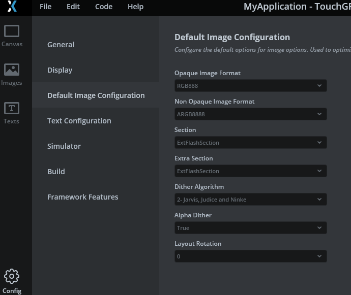

Any ideas as to what may be going on here? Not aware of anything else that must be setup in TouchGFX when using external memory, the image configuration in TouchGFX is already set to ExtFlashSection.
