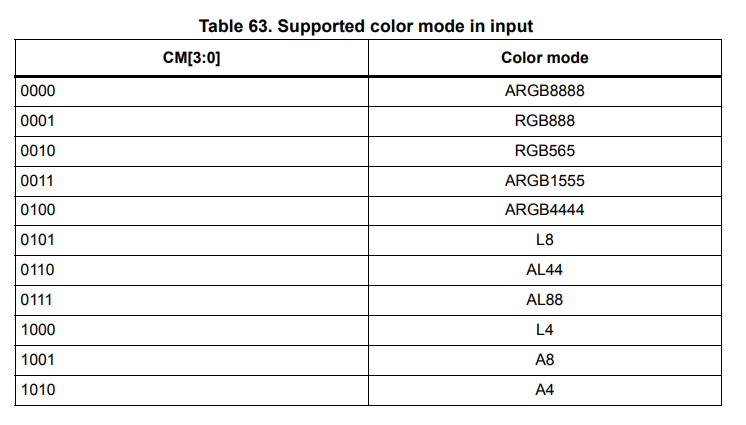

If, in your application, the LTDC synchronization with DMA2D and CPU, you must choose preset that is supported by DMA2D as shown in the below table.
