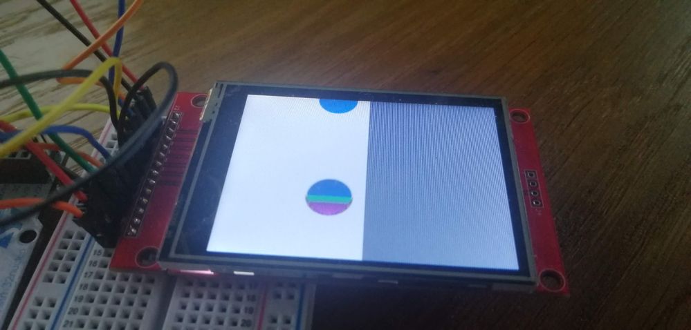

Since I don't have any demo boards at my disposal, I decided to play with some items I already have: an STM32F411RE based Nucleo and SPI ILI9341 based LCD. The problem number one in this project is a RAM size: a full 320x240 ILI9341 compatible framebuffer requires cca 150 kB, while STM32F411RE has 128kB. But for the sake of learning, I decided to go with it, and split the screen area in half. That means, I configure my LCD to 160x240 resolution, which in RGB565 requires only 75 kB framebuffer. My ili9341 library didn't have any problems with it and all the test functions worked, displaying images at half the screen only. So far so good.
But then, when I decided to integrate TouchGFX into my basic projects, it started behaving funny. Here's what I did:
But, the image is a bit weird. First, the button, that is supposed to be centerd is offset, and duplicated. Is there something in TouchGFX that would make such an image detoriation?

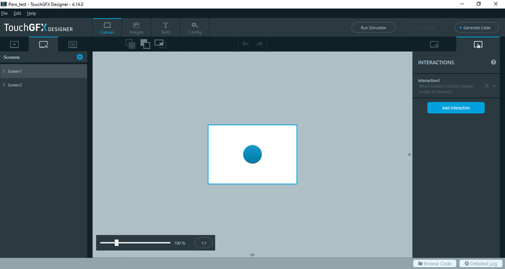

Of course, Here is both the screenshot from TGFXDesigner and photo of my actual screen .
Thanks for your interest in helping me, Alexandre!
2020-10-14 10:15 PM
It seems your UI in Designer is different from what you are trying to display. What I mean by this is that the orientation as well as the size in pixels of your canvas look wrong.
What is the setting in the Designer width x height for your UI ? And then what is the dimension of the the half screen ?
The orientation of your "half screen" needs to match the one on your display as well.

Hello Alexandre,
I think it might have been it. I modified orientation in the TGX designer from "landscape" to "portrait" and it did the job properly. However, I also needed to mofify @Martin KJELDSEN's original copyFrameBufferBlockToLCD function from the Documentation to this:
void TouchGFXHAL::copyFrameBufferBlockToLCD(const touchgfx::Rect rect)
__IO uint16_t* ptr;
int16_t height;
// Use default implementation (CPU copy!).
// This can be accelerated using regular DMA hardware
for (height = 0; height < rect.height ; height++)
//ptr = getClientFrameBuffer() + rect.x + (height + rect.y) * BSP_LCD_GetXSize();
ptr = getClientFrameBuffer() + rect.x + (height + rect.y)*(rect.width);
LCD_IO_WriteMultipleData((uint8_t*)ptr, rect.width+1);
}I think the reason for bad rendering was the wrong size of the framebuffer part I was feeding into the SPI DMA. Since the SPI only works with data lengths of 8 bits, while the framebuffer has 16-bit data points, I need to send twice the amount of pixels needed for single line. This "+1" at line 12 makes sure all of it sent, so that skew is avoided. Sweet.
