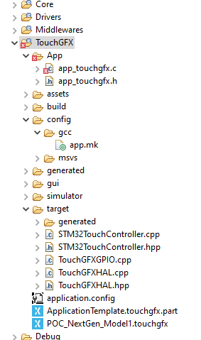

The problem is when i start compiling, almost no files from TouchGfx are being compiled. The drivers compile, the Core compiles, the touchGfx/App/app_toucgfx.c is being compiled. But none of the files inside TouchGfx/generated or TouchGfx/gui or TouchGfx/target are beling build/compiled and of course the build process fails because of undefined references.

As you can see some Drivers are compiled, as well as some "Cores" stuffs and the file ../TouchGFX/App/app_touchgfx.c But none of the other touchgfx related files gets compiled, although they exists (there are lots of cpp files in TouchGfx/generated, TouchGfx/gui, ... that are not compiled):
I supose i could try to understand what's missing in the makefiles but i'm pretty there must be some action i should do so that the ecosystem takes cares of this for me. I just can't figure out what i do wrong.

In the touchGfx folder i have actually 2 touchgfx "designer" files:
As i was not sure which one to open i tried with both.
Which one should i use ? and what is the purpose of the other one ?
