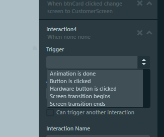

I made the animation run as TouchGFX Designer on the STM32F769I-DISCO board.
When i click the animation, I want to do another action(change the screen)
what should i do?

I'm not sure I follow what you are asking for, so if I don't answer correctly, could you provide more information (maybe some screenshot) ?
If you want to trigger an action when the button is clicked, simply use the Interaction tab in the Designer and create your interaction.
You can have a look at this page ("Step 4" section) : https://support.touchgfx.com/docs/tutorials/tutorial-02

Thank of your answer!
I tested the "change screen" with "Animation is done" and "Button is clicked" in the trigger of the interaction.
However, i want to do the change screen when i click on the animation while the animation is running.
