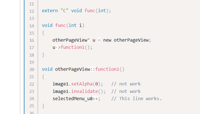

Finally I try the following code;
#ifndef OTHERPAGEVIEW_HPP
#define OTHERPAGEVIEW_HPP
#include <gui_generated/otherpage_screen/otherPageViewBase.hpp>
#include <gui/otherpage_screen/otherPagePresenter.hpp>
class otherPageView : public otherPageViewBase
public:
otherPageView();
virtual ~otherPageView() {}
virtual void setupScreen();
virtual void tearDownScreen();
virtual void handleTickEvent();
void f(int);
virtual void function1();
protected:
#endif // OTHERPAGEVIEW_HPP#include <gui/otherpage_screen/otherPageView.hpp>
#include <touchgfx/Color.hpp>
#include <texts/TextKeysAndLanguages.hpp>
#include <math.h>
#include <touchgfx/hal/OSWrappers.hpp>
extern "C"
#include "ram.h"
extern "C" void func(int);
void func(int i)
otherPageView* u = new otherPageView;
u->function1();
void otherPageView::function1()
image1.setAlpha(0); // not work
image1.invalidate(); // not work
selectedMenu_u8++; // This line works.
otherPageView::otherPageView()
void otherPageView::setupScreen()
otherPageViewBase::setupScreen();
void otherPageView::tearDownScreen()
otherPageViewBase::tearDownScreen();
}void func(int);
int main(void)
func(0);
while(1)
MX_TouchGFX_Process();
I called func from main.c. But image1.setAlpha(0); and image.invalidate(); command didn't work.
If I call the function1() from handleTickEvent all of commands is worked. Is this normal? Or is there any explanation about this?
2024-03-06 5:28 AM
This line
otherPageView* u = new otherPageView;seems problematic to me.
You are trying to create a new view for your "page" (usually called screen).
You are not supposed to do that, how is the compiler supposed to know which view your are referencing. The one you just created doesn't knows about your image1.
It is normal that when calling the function from handleTickEvent everything works fine as the view knows about the image.
Hence, the simplest implementation if to use the handleTickEven function as you would use your infinite while loop in your main.
Instead of calling the function from main, try to instanciate a bool to true, then in your handleTickEvent, check for the value of this bool, if it is true, do your modifications then reset the value.
This would look somehitng like that :
main.c :
bool myBool = false;
// after some time, when you want to modify your GUI do this
myBool = true;
view.hpp :
public:
otherPageView();
protected:
view.cpp :
#include <math.h>
extern "C"
#include "main.h"
void otherPageView::handleTickEvent()
if(myBool)
function1();
myBool = false;
image1.setAlpha(0);
selectedMenu_u8++;
Regards,
