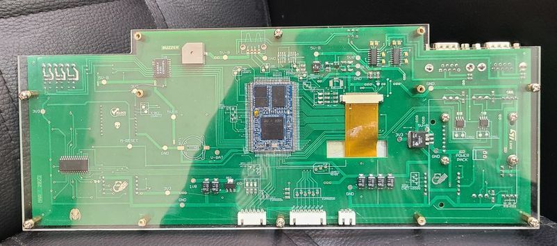

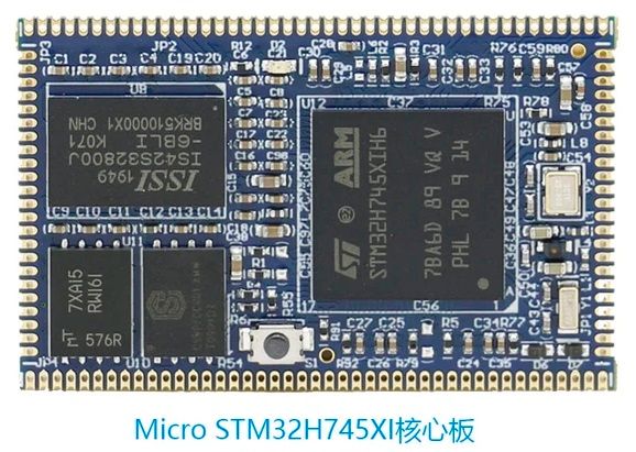

BTW .. my most recent TouchGFX experiment with custom designed board is across STM32H745XIT6 Core board with 1024X600 Chinese TFT .
The above board is with multiple communication protocols . and this customized board is based on following Core Board.

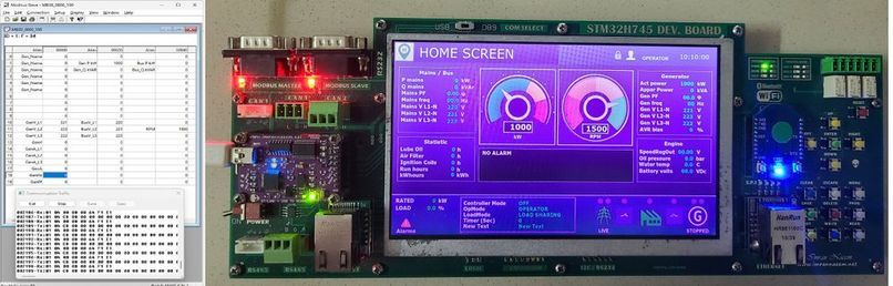

I also implemented Modbus Master RTU with TouchGFX on my previous development board.
Simulated the Modbus values from ModBusSlave utility on laptop and observed values on TouchGFX in numeric figures , custom guages & vertical bars.

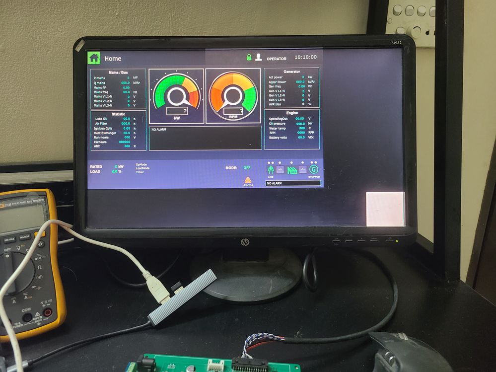

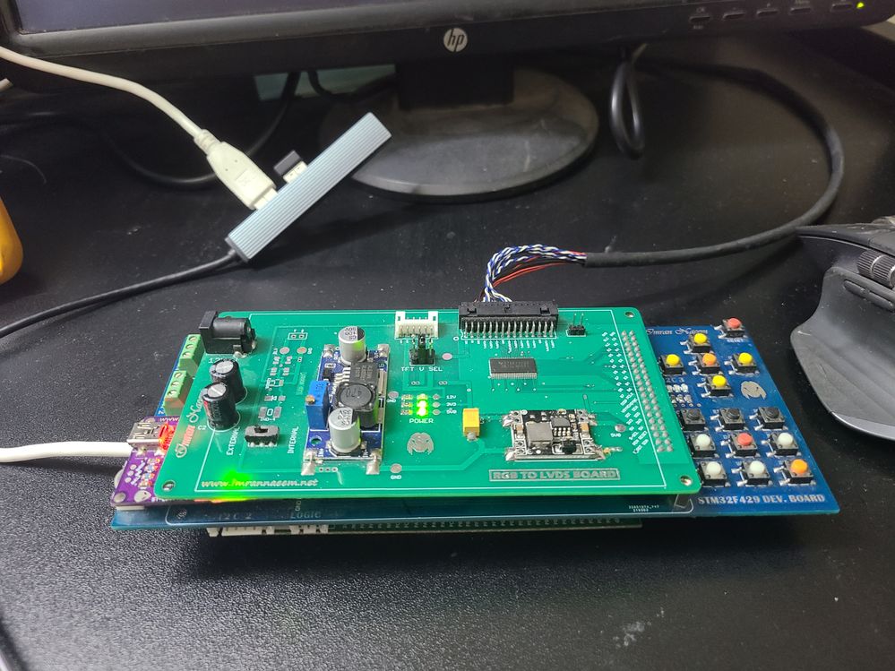

Here is TouchGFX running on HP S1932 18.5" Monitor's LVDS LCD with 1366x768 resolution .
The lcd part no. is LTM185AT04 or Equivalent . The driver is stm32f429i-discovery + sn75lvds83b
BTW ,, I tested ThinkPad T400 TFT 1280x800 resolution with my RGB>LVDS and working fine.
