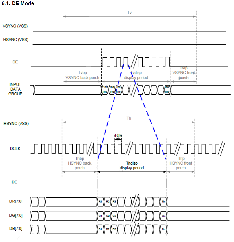

My MCU is a STM32H753BIT6. This is a custom board that works fine with SYNC-MODE displays types.
I have a new display only works in DE MODE. It not requires the HSYNC or VSYNC signals.
Is there any way to configure LTDC peripheral and TouchGFX to work only in DE MODE? This is a communication image about this mode.
I disconnect physically the VSYNC/HSYNC signals and ground it to make sure.
Thanks for any tip and help!

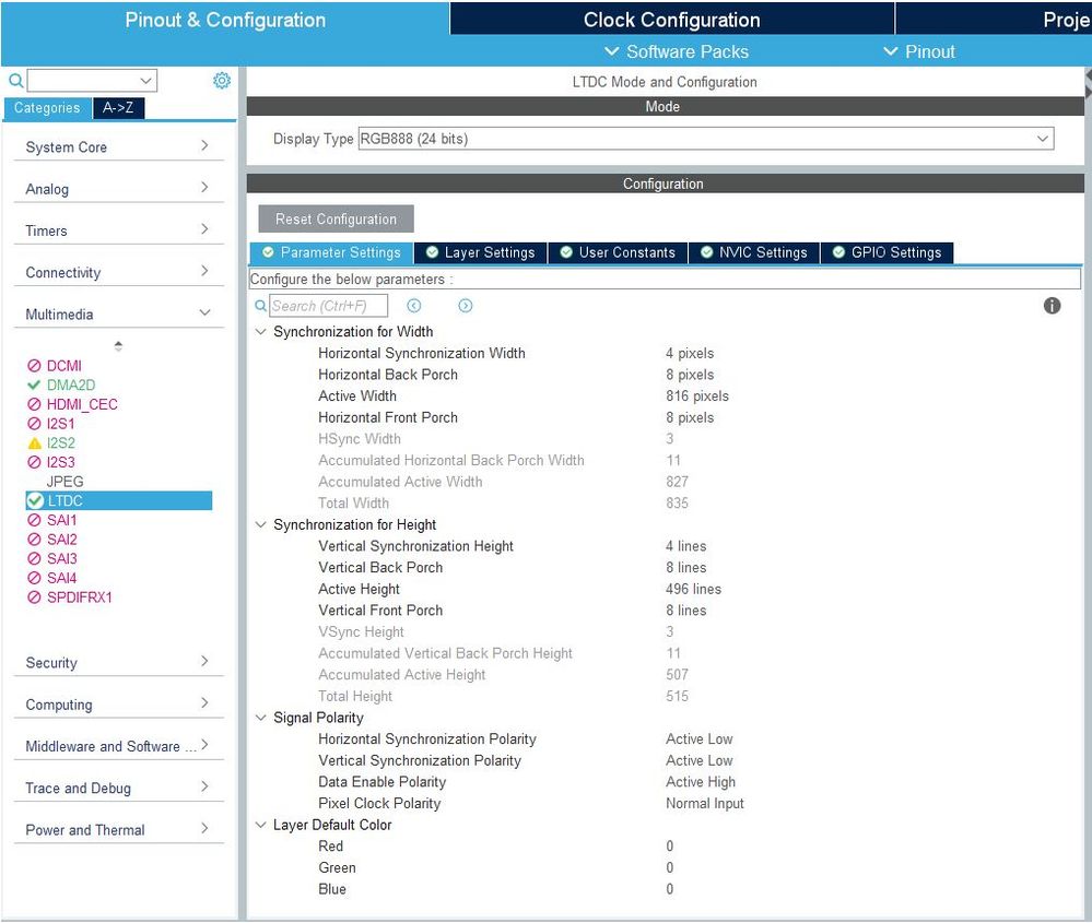

2023-06-06 1:38 AM
What is your display model? Do you have datasheet? I would start with comparing "hsync/vsync" and "de only" waveforms...

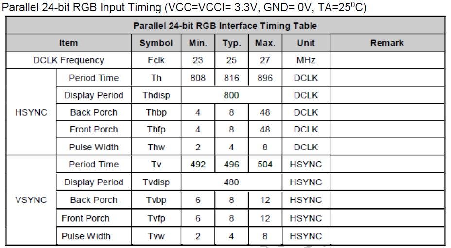

I can not upload the file here, just some prints.
This is the timming table

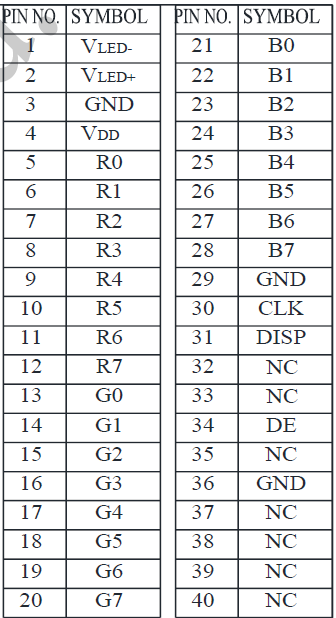

Resumed pinout: note there is not VSYNC and HSYNC

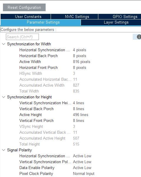

Then my CubeMX setup (My LTDC clock is 25MHz):
Let me know if you need more informations.

2023-06-06 11:15 AM - edited 2023-11-20 3:54 AM
It works =)
I change the settings to:
Also I reconnect the VSYNC and HSYNC signals to LTDC peripheral. Without it the display keep dead.
Just after these modifications that I mentioned it worked.
I had some flickers in transaction screen and animation widgets, but reducing a little bit the LTDC_CLK it works well. (Fine tuning)
@ktrofimo thanks to help me with it.
