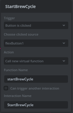

I'm fairly new to TouchGFX as well as C++ inheritance so trying to understand how to implement a custom virtual function when a key is released. I see when I create an interaction in touchGFX so when a key is pressed it calls a virtual function...

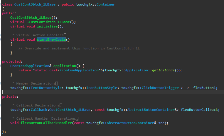

Which creates the following in the base class of the custom container...

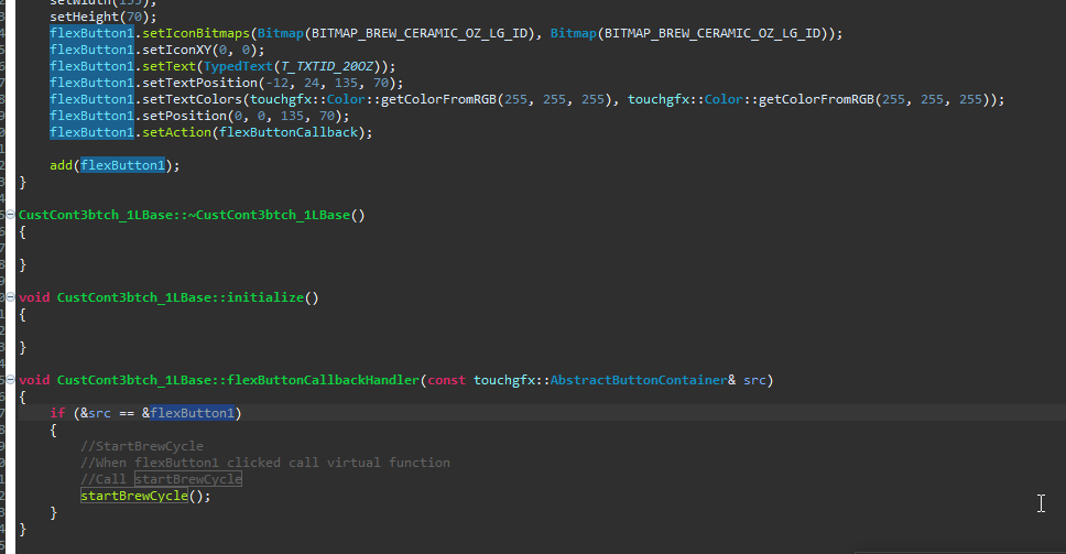

I understand how to override the startBrewCycle() virtual function in the non-base cpp file which is called with the pressed even in the callback below...
How can I implement another virtual function stopBrewCycle() when the same button is released?

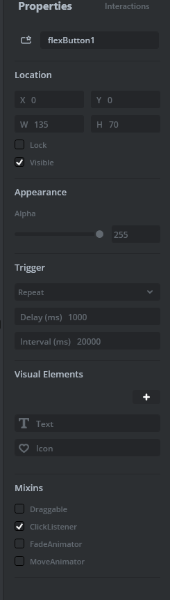

I found my old example, just modify it for flexbutton, maybe this helps. The flexButton click handler is bit more tricky than other button types. Here in the example flexbutton has just Box with border- element.
One way is to create ClickListener to the FlexButton, so set it on at Mixins of your flexButton:

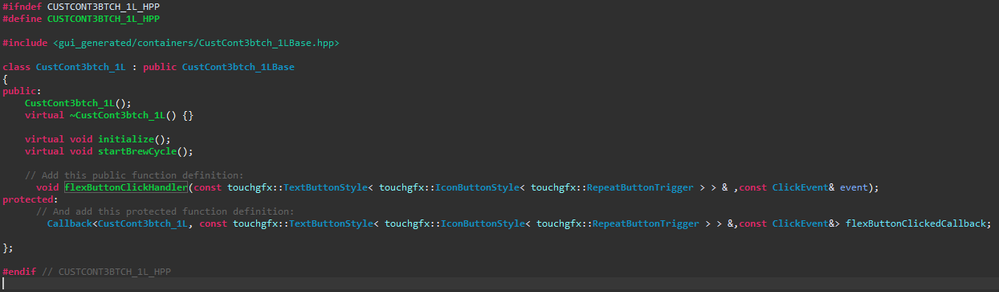

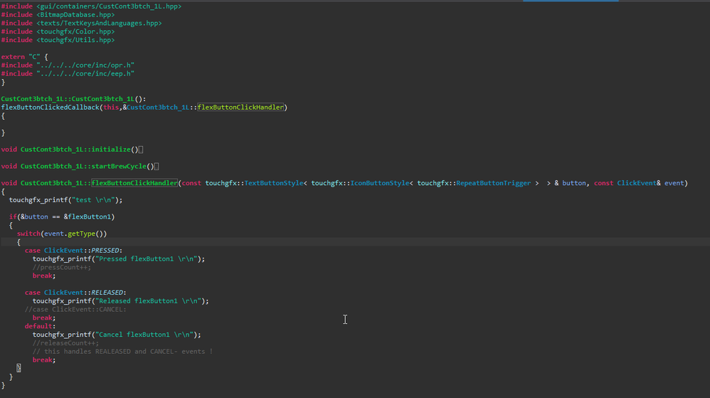

2023-07-06 2:32 PM - edited 2023-07-06 2:33 PM
2023-07-06 9:17 PM
Hello. Hmm...did you put 'setAction' - call to the 'initialize' - function ? Otherwise it looks ok with quick review.
You can also test the functionality by changing trigger to 'click' instead of repeat, i have never use click callbacks with repeat button.
Br. J.T
2023-08-09 12:21 PM - edited 2023-08-09 12:48 PM
was missing the setAction in initialize, thanks so much for the assitance
2023-08-09 12:45 PM
Thanks JTP1...I was missing the setAction. Totally missed you had sent a reply on 7/6. Thanks again for the assistance!
