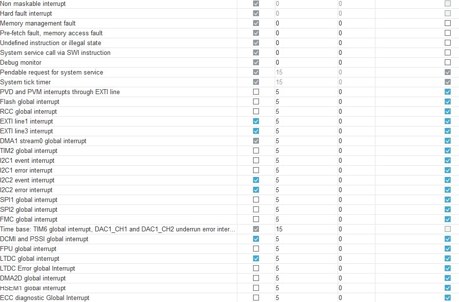

As there is a description in the source (port.c) on why the assert can fail, I checked my NVIC.

I really don't see any problem with the interrupt priorities here.
