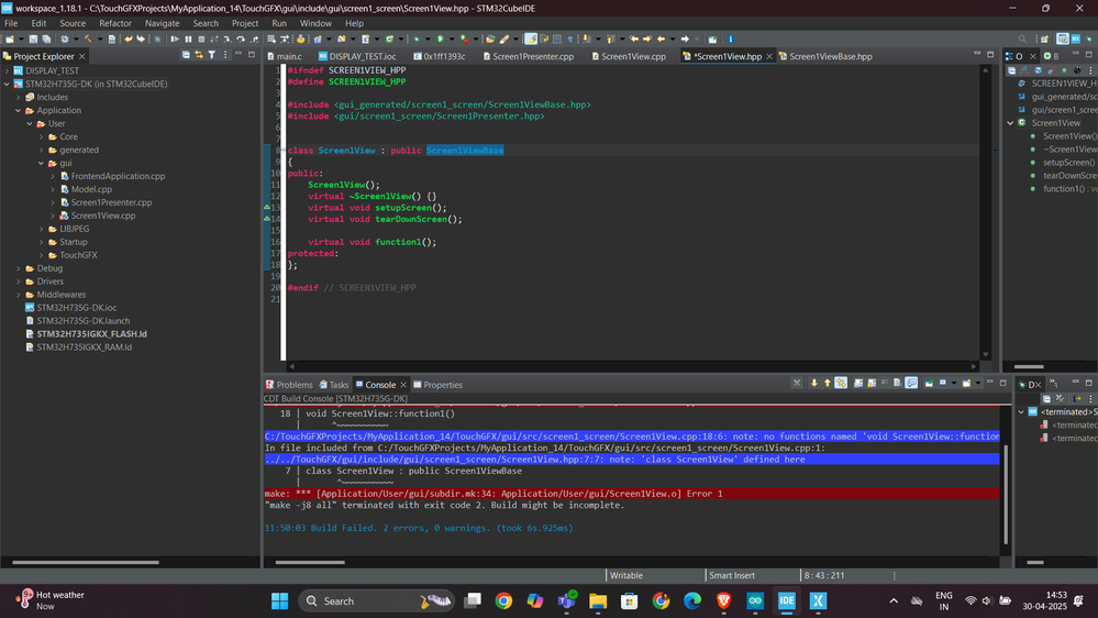

There is a * in front of your hpp file name, this is because the file have has a change and you did not save.
Perhaps you added the line 16 and did not save, so for the compiler, the line 16 doesn't exist and same for the zipping program.
Can you save your file and try again?
removing the function definition in the cpp file
it will compilee the code that i checked
If my guess above is right then yes, removing the definition in the cpp would compile fine (I have also tried that with the zip file you shared and it worked for me too).
but even if i add function definition in cpp file it should compile right ?
If you only add a function definition in a cpp file but no function declaration in a hpp file, I don't thing it would compile.
However, having a function declaration in a hpp file but no function definition in cpp would compile.
Alternatively you could also directly do both the declaration and the definition of the function at once in the hpp.
I think the first step would be to save your project and try again to compile.

The reason is that the function declaration un your hpp file is missing (your hpp file is not the same as the code you shared in your first post).
After adding the function declaration to the hpp file (or removing the function definition in the cpp file), it compiled fine.

2025-04-30 6:18 AM
You can also unzip the file and sent me and you will see that there is no function declaration in the hpp.

2025-05-02 9:09 PM
Got it sir!!!
It was not getting saved that was the issue
thank you soo much sir!!
