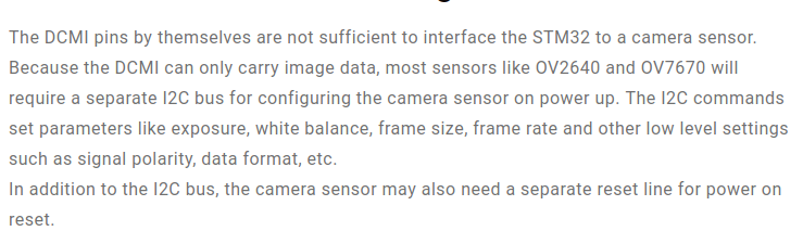

Picture:
Does this mean that I only need to connect the DCMI pins to the camera + I need to connect the I2C pins to the camera as well?
Then I only need to write the I2C commands that can be found inside the data sheet of the camera module?
Yes, for camera control. The camera init sequences tend to be long, so you should look
You must also take care of the supply voltages and possibly level converters for IO, depending on your camera module. Look for reference designs, the chip is not new.

So the DCIM will handle the data by it self. But all I need to do is to control the I2C for the camera?
