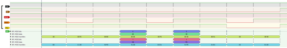

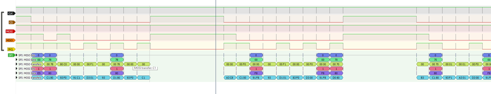

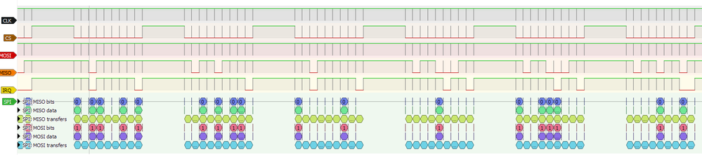

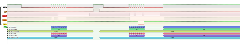

Associate II
Thanks, Ive actually managed to port the display, unfortunately the touch screen doesn't work. I ve checked SPI and ehrn I dont connect miso/mosi external interrupt works, but once I connect it, it triggers without touching. 0693W00000NqVHEQA3.png0693W00000NqVH9QAN.png0693W00000NqV2HQAV.png0693W00000NqVH4QAN.png
