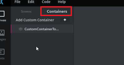

You will have to create a custom container (also called a custom widget) : custom widgets
To do so, you basically have to create your clock inside a custom container :

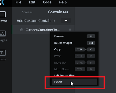

Once you are done, right click on the name of your custom container and click export :
Make sure to change the name of the typography you will use (don't keep it called "default") otherwise you will have errors when importing it from another project.
Once you exported your custom container, it will be saved as a .tpkg file in your project's folder.

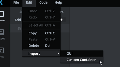

Finally, you can import it in another project by clicking edit, import and then custom container :
