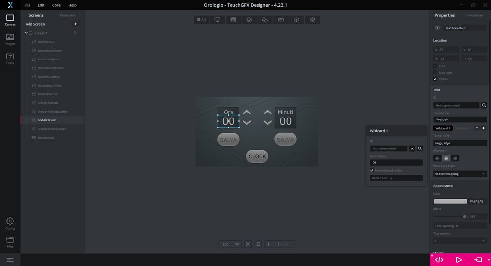

Good morning , sorry if i'm not posting in the right place but i'm still learning. I have a problem with an example i saw in the tutorial where you bild an iterface to adjust the hour and minutes . In the tutorial where i built the interface it says to copy the code and put it in two files .... i tired but when i press the buttons mothing happens and in the two text areas thereare two question marks. Could someone kindly help me? Thank you so much.

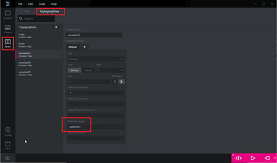

Hello @StefanoL ,
It seems like you are stuck at the very beginning of the tutorial where they say :
If you press "Generate Code" or "Run Simulator" the specified virtual functions will be generated by the Designer. Let us start by integrating the four functions for the arrow buttons. To keep track of the values for hour and minute, two counters are also added.
Now add the following code:
The issue there is that you added a wildcard but did not specify the characters this wildcard can take.
You need to specify which characters can take by going into "Texts", "Typographies" and than filling the fields "Wildcard ranges" for example :
In this case my wildcard could take all the ASCII values.
In your case you just need numbers do you could either type "0,1,2,3,4,5,6,7,8,9" or "0x30-0x39".
