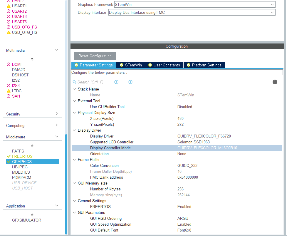

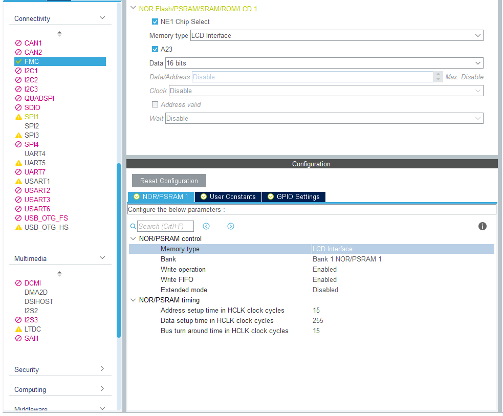

I configured the display and drivers using cube. These are the main configurations for the display:

And when I try to display the simple example with "hello world", the mcu writes only to 2 of the data pins...
