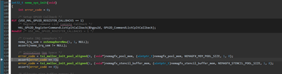

I am using a STM32H7S78-DK and I created a project using TouchGFX Designer with the default empty template. However, when I try to run it, the board immediately hard faults.
Stack Trace:
main()
└── MX_TouchGFX_Init()
└── touchgfx_components_init()
└── nema_init()
└── nema_sys_init()
└── tsi_malloc_init_pool_aligned(1, (void*)nemagfx_stencil_buffer_mem, (uintptr_t)nemagfx_stencil_buffer_mem, NEMAGFX_STENCIL_POOL_SIZE, 1, 8);
I've seen some some discussions where the CRC could be the problem, everything seems fine with the CRC, and i don't think any of the issues are directly related to the NeoChrom GPU.
A while back i tried the same project setup, and it was fine. After that i was checking Rust with Embassy and adding lvgl to an empty project. I'm not sure if it could be related, it might just be a weird coincidence.

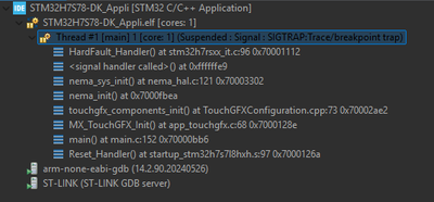

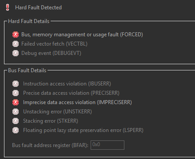

2025-03-26 9:04 AM
The steps to achieve it are:
After this it crashes.
Debug window
Fault Analyzer window
nema_hal.c file

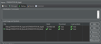

2025-05-05 4:48 AM
Hello @diogomargalho ,
Have you had time to try to flash through STM32CubeProgrammer?
Regarding STM32CubeIDE, perhaps you should not add the boot elf to the application startup, simply build both the boot and appli, then flash the boot, then flash the appli, then run.
