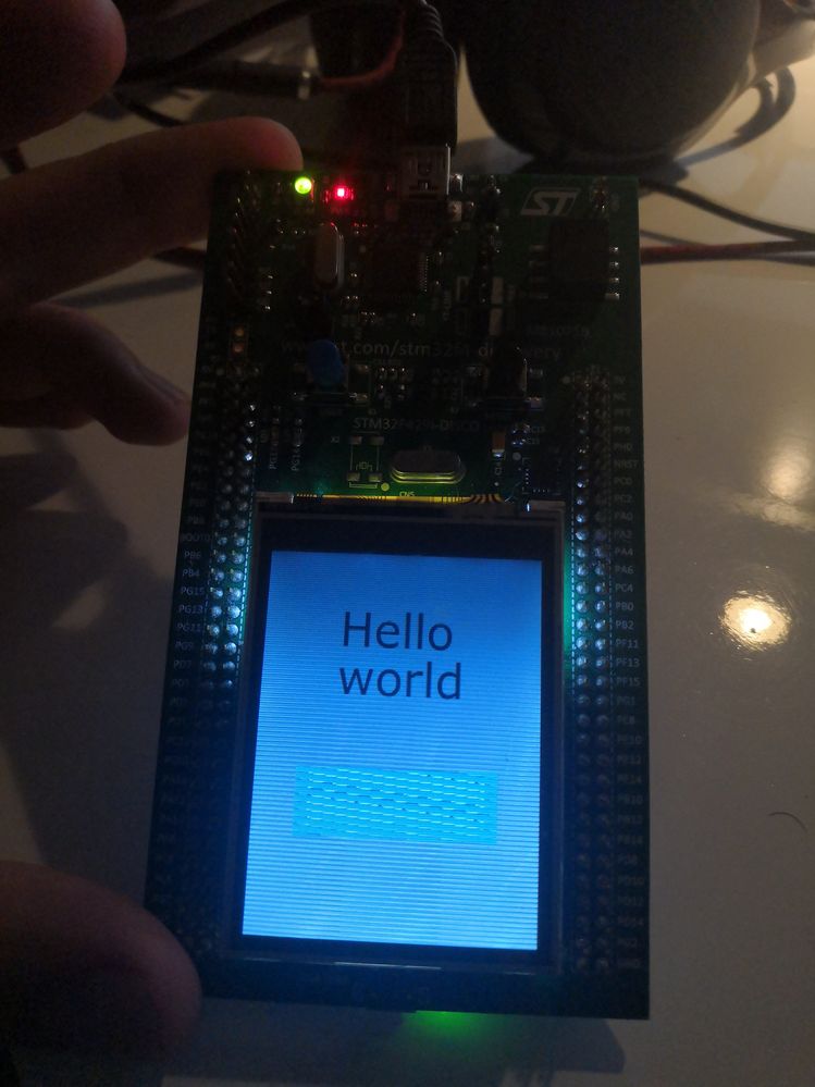

I'm trying to setup a simple example on my STM32F429I-discovery board, but i'm experiencing issues with some graphics (images).
I had setup CubeMX using this guide : https://touchgfx.zendesk.com/hc/en-us/articles/360021620431-Configuring-STM32F429I-DISCO
As you can see on the picture above, the text is displayed fine, but the background image and the button are corrupted. However, LCD seems to work properly, because the text is correctly rendered.
I'm using EWARM 8.22.2 and the lastest versions of TouchGFX and CubeMX. The project compiles fine.

Could you check your map file and check where that image is placed by the linker? And
then check that memory to see that flash has been programmed correctly?
Did you get any warnings when flashing?
/Martin

I tried to verify the checksum of the flash, do a full chip erase, and re-program the flash, and i still get the exact same issue.
I didn't get any warning or error while flashing.

this does look familiar when the program assumes that the assets are located in external memory but they aren't loaded properly. How do you load the external flash?
Martin KJELDSEN
Chief III
There's no definition for the ExtFlashSection (Generated by the image converter in TouchGFX) so the linker defaults to internal memory. I don't really see why they wouldn't be loaded. I'll have to think about it.
/Martin
but there is a reference to the ExtFlashSection for the assets - or is the hex value the starting address? I'm not familiar with the .map files
What triggered me was the remnants of the button - you can almost see the outline of the button which means that there could be some residue data from another process. For example if one was testing with the designer first (and it worked) and then tried uploading the code from CubeIDE where no external loader was present.

I tried to put all the assets in the "IntFlashSection" (TouchGFX designer parameters), and I got the same issue.
The STM32F429I-DISCO board doesn't have any external flash chip (only the MCU+SDRAM).

You could try creating a completely RED image and then checking the address of the linker script to see if you can read RED from the memory. I can't imagine that the flash has been programmed properly with the images.
/Martin
It doesn't, but if the ExtFlashSection isn't defined in your linkerscript anyway you can see that it's already using internal flash. The imageconverter just always outputs the ExtFlashSection pragma so that the user can define it in his or her linker script

I tried this example :
https://s3.amazonaws.com/axxonshare/my_combo_tutorial.zip
And somehow, it worked for me... but I'm unable to explain why, the project seems configured exactly as mine (the linker aswell).
