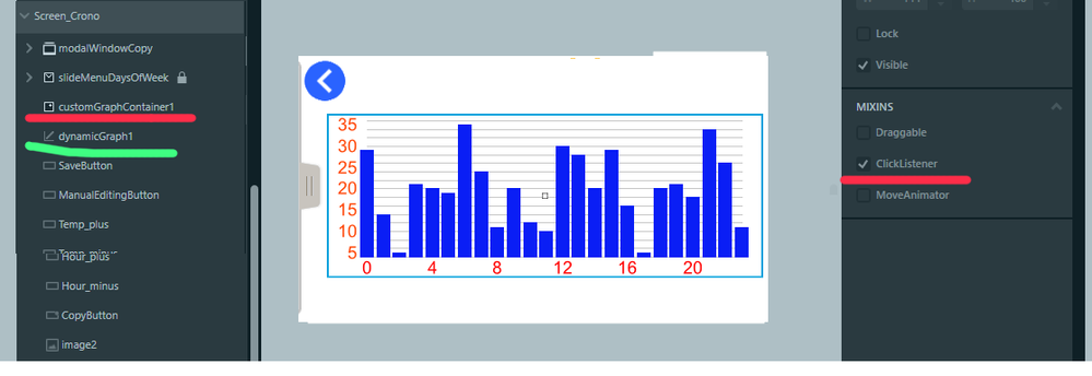

2021-04-17 10:22 AM
Hi Romain,
I added a custom Container over a graph and I enabled ClickListener on the custom Container. Obviously the custom container has the same size as the chart box
But not events are generated.
I have void Screen_CronoView::handleClickEvent(ClickEvent& evt) routine and
virtual void handleClickEvent(ClickEvent& evt) prototype.
I'm sorry but I don't understand what i'm wronging or what I'm missing.
Do you have some hints?
thanks

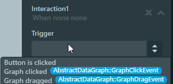

2021-04-23 2:33 AM
Hi!
In the interactions, enable the clickEvent for graph, it is already integrated in the graph widget.
Then in your function take the coordinates from the event.
Regards!
