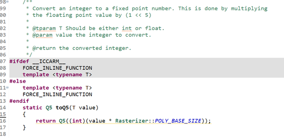

Dear Gfx Team,
CWRUtil::toQ5 causes Cube compiler giving this warning
c:\TouchGFX\4.24.1\touchgfx\framework\include\touchgfx\widgets\canvas\CWRUtil.hpp
../touchgfx/widgets/canvas/CWRUtil.hpp: In instantiation of 'static touchgfx::CWRUtil::Q5 touchgfx::CWRUtil::toQ5(T) [with T = float]':
../touchgfx/widgets/canvas/Canvas.hpp:120:36: required from here
../touchgfx/widgets/canvas/CWRUtil.hpp:518:31: warning: arithmetic between floating-point type 'float' and enumeration type 'touchgfx::Rasterizer::<unnamed enum>' is deprecated [-Wdeprecated-enum-float-conversion]
518 | return Q5((int)(value * Rasterizer::POLY_BASE_SIZE));
Could you possibly cast Rasterizer::POLY_BASE_SIZE to the static_cast<T> :
static Q5 toQ5(T value)
return Q5(static_cast<int>(value * static_cast<T>(Rasterizer::POLY_BASE_SIZE)));
What do you think ?

2025-01-07 5:29 AM
"can you tell me in which file it is located?"

2025-02-03 1:59 AM
Hello @ferro ,
It seems we have implemented the change.
It should be available now or in the next release coming soon.
Regards,
2025-02-05 1:03 AM
Lovely. MSVC C++17 does not complain but MSVC and CubeIDE C++20 does so nice its sorted @GaetanGodart .
