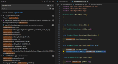

I've tried using the Wheel menù demo you provide with the circular display.
I've set the new functions in the hpp file
#include <gui_generated/containers/MainWheelIconBase.hpp>
class MainWheelIcon : public MainWheelIconBase
public:
void setCenterXY(int16_t x, int16_t y);
int16_t getCenterX() const;
int16_t getCenterY() const;
protected:
and in the cpp
void MainWheelIcon::setCenterXY(int16_t x, int16_t y)
subDemoIcon.setX(x - static_cast<int16_t>(subDemoIcon.getWidth() / 2));
subDemoIcon.setY(y - static_cast<int16_t>(subDemoIcon.getHeight() / 2));
int16_t MainWheelIcon::getCenterX() const
return (subDemoIcon.getX() + static_cast<int16_t>(subDemoIcon.getWidth() / 2));
int16_t MainWheelIcon::getCenterY() const
return (subDemoIcon.getY() + static_cast<int16_t>(subDemoIcon.getHeight() / 2));

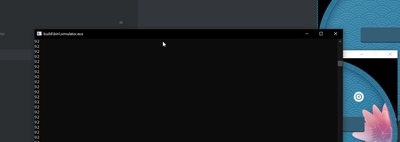

Now if I set the position with .setXY() , .getCenterX() returns the same value of.getX(). I'm sure getWidth() is not 0
It seem that setCenterXY doesn't actually draw the image

I have tested and subDemoIcon.getWidth() returns 92 :
"It seem that setCenterXY doesn't actually draw the image" indeed, you do not invalidate the widget and I don't think setX and setY redraw the widget by default.
Try adding subDemoIcon.invalidate();.
