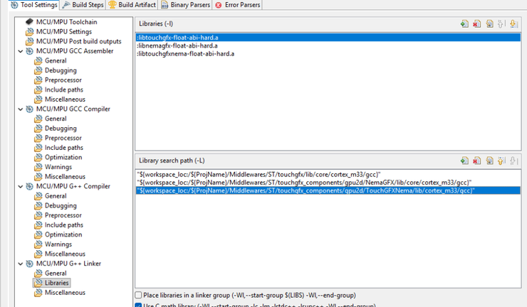

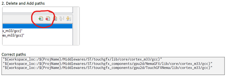

Hi @Ofer
Your linker lib search paths might be wrong. Try to tinker with following settings
"${workspace_loc:/${ProjName}/Middlewares/ST/touchgfx/lib/core/cortex_m33/gcc}"
"${workspace_loc:/${ProjName}/Middlewares/ST/touchgfx_components/gpu2d/NemaGFX/lib/core/cortex_m33/gcc}"
"${workspace_loc:/${ProjName}/Middlewares/ST/touchgfx_components/gpu2d/TouchGFXNema/lib/cortex_m33/gcc}"

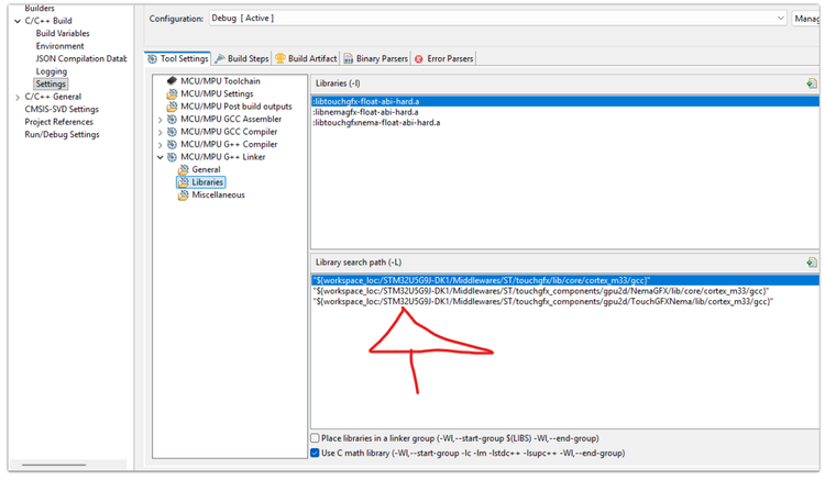

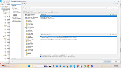

2026-02-03 7:52 AM
thank dear Ferro but it seems to me my settings are exactly like yours but i get those errors

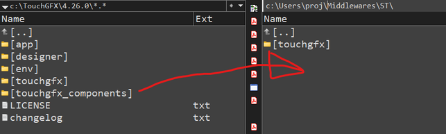

2026-02-07 4:53 PM - edited 2026-02-07 4:54 PM
Try to copy folder
c:\TouchGFX\4.26.0\touchgfx_components
into your project folder
<your\project\path>\Middlewares\ST\

2026-02-08 3:32 PM
hi dear mm1
i tried it this way but i got all this issues this way
