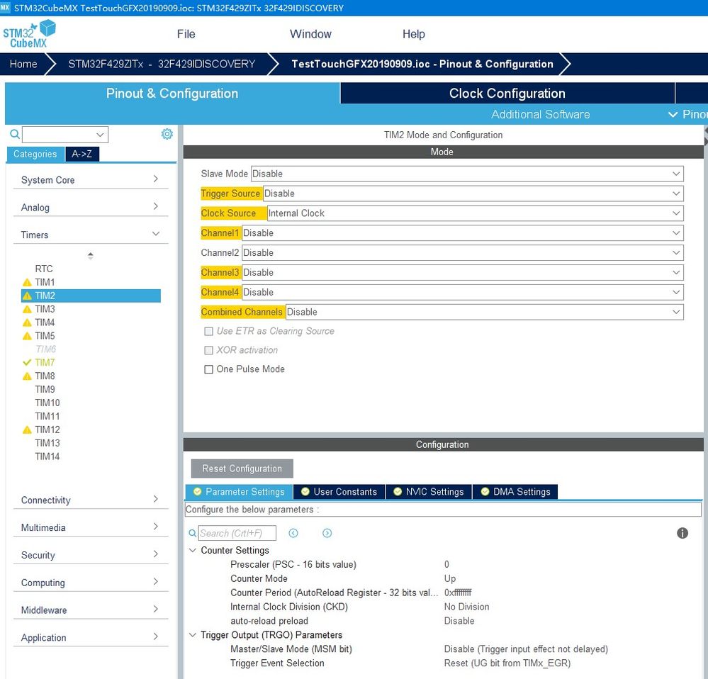

2019-09-19 7:34 AM
The Tim1 is 16-bit, The Tim2 is 32-bit.
So Timer selection Tim2.

2019-09-19 7:42 AM
STM32CubeMX :
