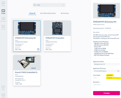

Could you confirm me that the version of the TBS that you use is 3.0.19?
Can you confirm you haven't added any changes and it's just a blank UI?
2025-12-09 1:20 AM
Yes I can confirm all of this. Also that the project compiles through the TouchGFX environment, but not from within designer itself.
