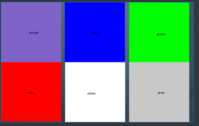

I am working on a Riverdi Screen RVT101HVSNWC00 using STlink2, and I am trying to display colors using touchgfx designer.
This is a screenshot from my Touchgfx designer Application

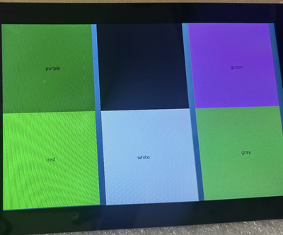

And this is the output on screen:
I don't understand the logic of displaying colors...
I thought at first that it is read as BGR instead of RGB but it's not the case because blue is displayed as black for example and red is displayed as green instead of blue.
Do you have an explanation of this behavior?

Hello @EYA_GE ,
I heard from our partner that the issue is now resolved by setting color format to 16bit.
Best regards.
