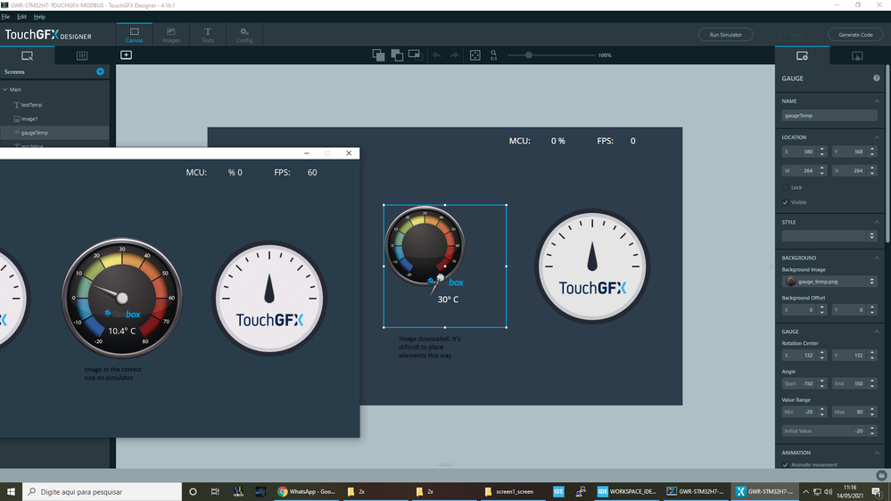

When I change the gauge background or the needle my custom image gets downsized on the Designer app difficulting the job of aligning and placing things. Is this a known bug?

Hello Dolence,
Yes this is a known bug. It's probably because your pixel density (dpi) is not 96 dpi. Have a look at this community post : https://community.st.com/s/question/0D53W00000TGqxM/custom-gauge-background-image-not-displaying-correctly-in-touchgfx-designer-416
A fix should be released in the near future but for now changing your image dpi is the best solution.

2021-05-17 10:05 AM
Hi Alexandre! Yes, it indeed worked with 96 dpi density. I'm closing it. Thanks for your response.
