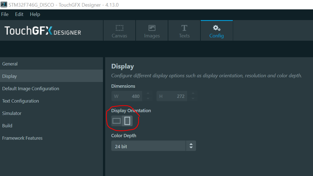

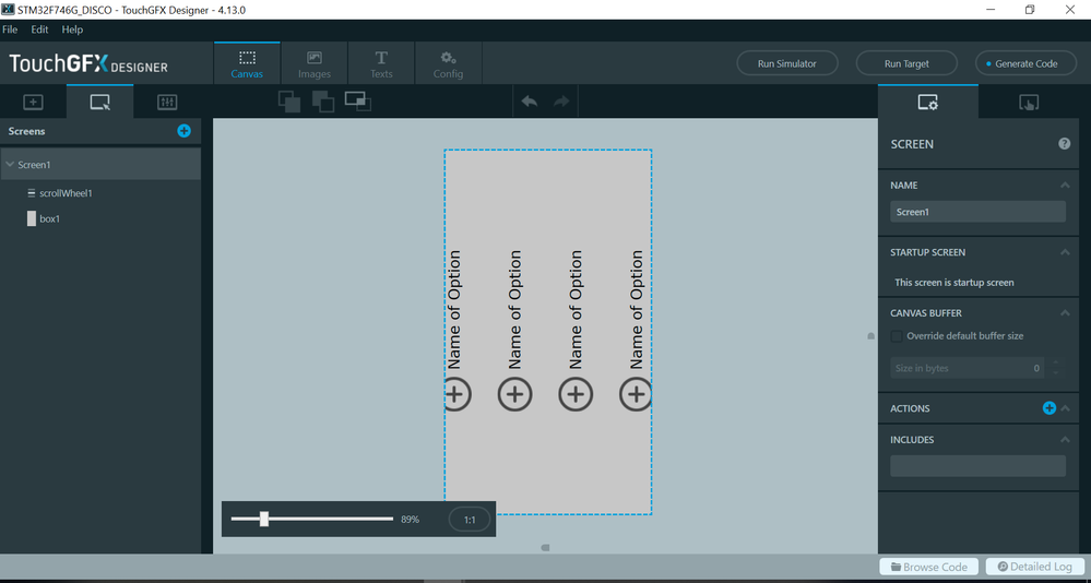

The swipeContainer does not handle vertical swiping. You can implement yours if you look at the available code but it might be a bit complicated. Another terrible solution I used once was to go in the Config tab and change the display Orientation.
Then I did my GUI sideways to simulate the board being hold sideways. You can then use the swipe container as a fake vertical swipe but it is annoying to adapt and rotate all your images/text/animations...
This was fine enough for a simple project, i would not recommend it for a huge and complex project.

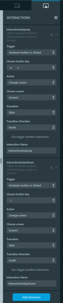

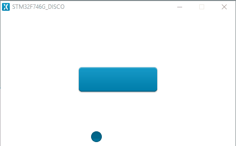

to simulate a vertical swipe container you can use the handleDragEvent function and set a distance the user has to drag before going to another screen. When you select the transition "Slide" and the correct direction it can give a smooth effect like the normal swipe container. You can develop yourself the threshold and elastic animation when you reach the border of a swipe container if necessary. I did a very short project so that you can have a look at the handleDragEvent function. I also added two fake interactions to enable the use of the swipe container functions with a specific animation ( slide north or south).
2020-02-24 3:47 AM
The thing here is your doing vertical swipe as horizontal swipe with with drag event but i want directly the vertical swipe and i don't want slide i want there also swipe...as how your displaying button,one square and circle...if i do vertical swipe i want to display some other images after each horizontal swipe...

wait have you tried to swipe up with my project? this is what i implemented. The horizontal swipeContainer is just here as an example. It is the best I can do to simulate a vertical swipe

I have tried your example some times that vertical swipe is not working...some times it is taking vertical swipe as horizontal....if i do vertical swipe continuously and if i stop after that it is not working...and after doing horizontal swipe if am trying to vertical it is not working...
so many issues in this both swipes....
What is the reasons for these issues...
