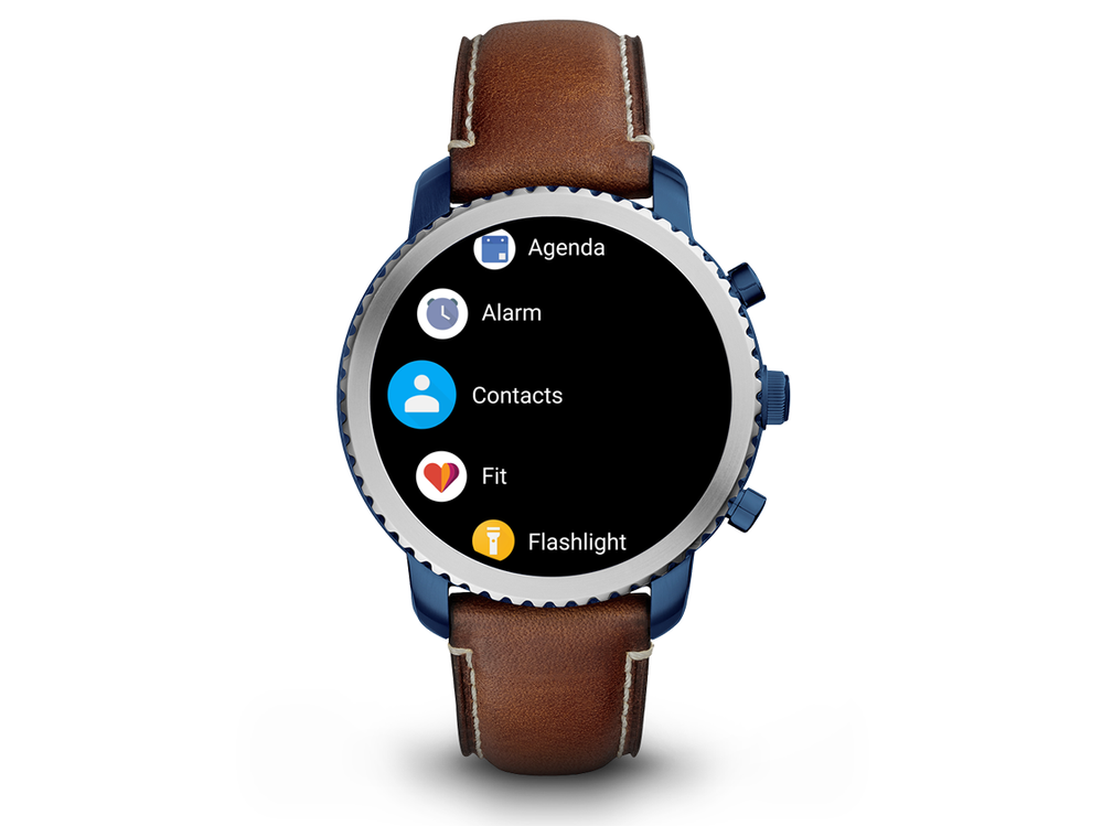

2020-02-20 10:27 PM
hello Martin....
i want do scrolling but in a arc manner...not vertically means vertically only but some with arc(angle)
thank you
2020-02-20 10:29 PM
like....in the image
2020-02-20 11:48 PM
Hi prathima, what you wish to do in that image is what is done in Tutorial 4 using a scrollWheel and modifying its Y value. You can compare the result and see the code here. Hope this helps,
/Romain

yeah,,,but is this location y location
y=y + getheight ( )/2-390/2;

2020-02-21 12:58 AM
I meant X value my bad. But just do the same code as in the tutorial and you will get this nice arc.
2020-02-21 2:43 AM
yes ..i got it:) thank you so much...
