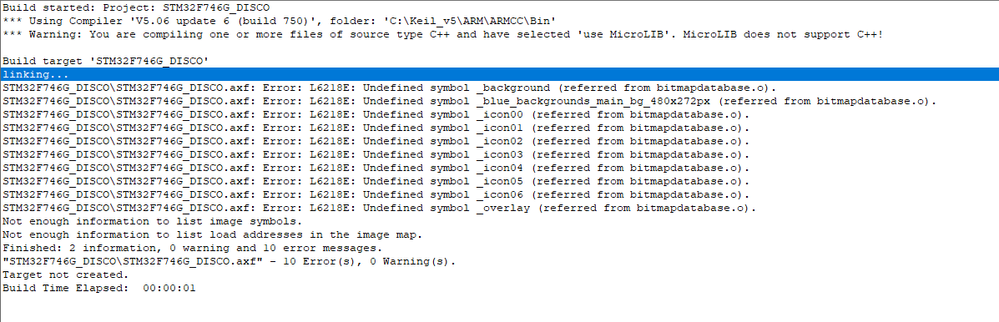

Hello Romain,
In my project in TouchGFX 4.13 i choose STM32F746G-DISCO template and place some icon, after that i "Run Target" -> It run normal.
I have try to build program by MDK-ARM (KeilC). but not success with message as bellow
Do you have any document for that.

2020-02-26 1:08 AM
It seems your image assets haven't been added to the project. TouchGFX designer can update Keil, IAR and CubeIDE projects, but the chosen IDE must be reflected in the .ioc file for a project. So maybe you selected IDE in CubeMX is set to something else than Keil.
Simply open the IOC file, choose Keil, save, and generate again from TouchGFX designer - Or, simply add all your assets manually if that's fine for you.
/Martin
