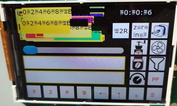

The application runs (it’s just a test application) but I get even characters garbled: 0 is ok, 1 garbled, 2 ok, 3 garbled.

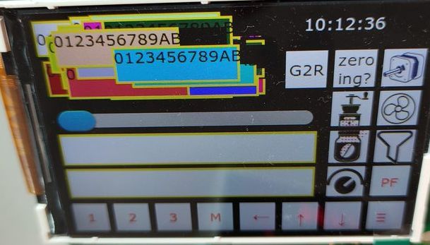

Running the exact same application but changing
FontFlashSection :
*(FontFlashSection FontFlashSection.*)
. = ALIGN(4);
} > RAM_EXECMakes it work perfectly: see picture below.
Any hints on how to solve this?

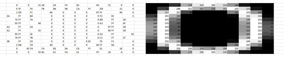

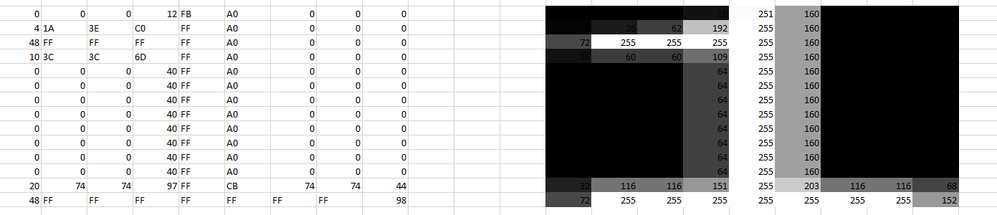

I've placed a breakpoint in the GeneratedFont.cpp function getPixelData:
const uint8_t* GeneratedFont::getPixelData(const GlyphNode* glyph) const
const uint8_t* const* table = (const uint8_t* const*)glyphData;
return &(table[glyph->unicode / 2048][glyph->dataOffset]);
}And with memory browser I've downloaded the data at the returned address.
For glyph 0 I get
for glyph 1 I get:
So glyphs are ok. What's going on with the library?
