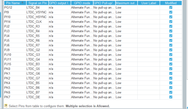

This is my pin configuration
And the pin mentioned on video "PI12"
And Still having black screen on debug.

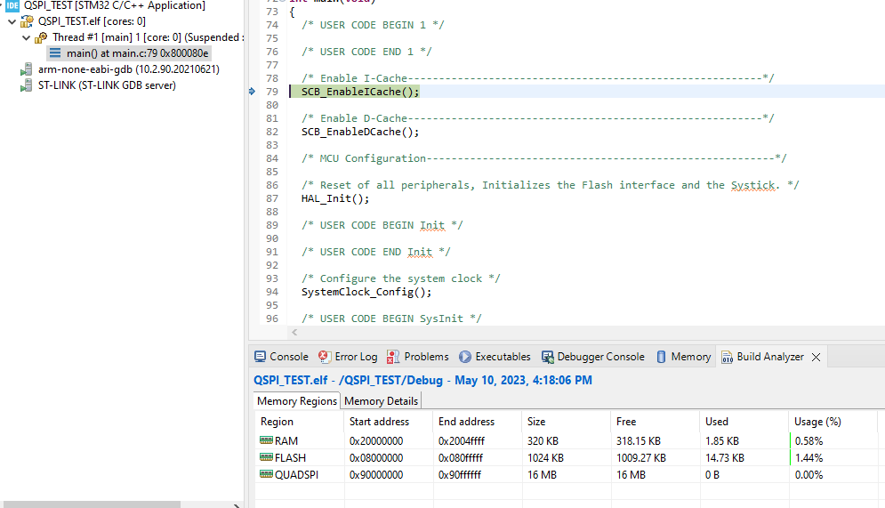

Hai bro Still I am working in QSPI concept in stm32f746 disco board
I tried to write the data for QSPI flash memory but I can't able to write and read the QSPI flash memory i need your help bro i have attached my code and snap pls find and give any sollution are example code
