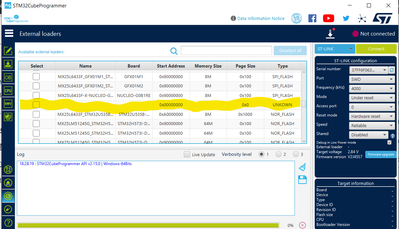

I separately tested it. But xxx.stldr file is not working. STM32CubeProgrammer is unknown my STLDR file.

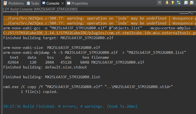

I build without any problem. I checked that makefile under debug folder. There is an error that:
fail-specified-linker-script-missing:
@echo 'Error: Cannot find the specified linker script. Check the linker settings in the build configuration.'
@exit 2
warn-no-linker-script-specified:
@echo 'Warning: No linker script specified. Check the linker settings in the build configuration.'
.PHONY: all clean dependents main-build fail-specified-linker-script-missing warn-no-linker-script-specified post-build

The empty fields in STM32 Cube Programmer is indicative that the StorageInfo structure has not been built/bound correctly.
You could look at the .MAP and perhaps inspect with objcopy or objdump
