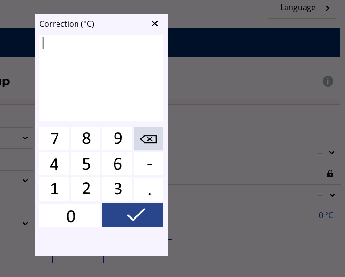

I'm trying to share buffer between files but sometimes I get value sometimes not. And this is how I do this.
First of all I have button and inside button is text when I click the button it shows modal window and there is keypad. By keypad I write some numbers and click save.
When I click "0°C" shows keypad and KeypadSelection set to one:
I save text like this, it copies to KeypadBuffer:
void Keypad::savedText()
char* buffer_new;
buffer_new = getText();
Unicode::strncpy(KeypadBuffer[KeypadSelection], buffer_new, Unicode::strlen(buffer_new) + 1);
viewPtr->CloseButtonAction();
}And by extern I pass buffer between files. And here change correction value
if(Unicode::strlen(KeypadBuffer[1]) > 0)
memset(&correctionvalueBuffer, 0, CORRECTIONVALUE_SIZE);
Unicode::strncpy(correctionvalueBuffer, KeypadBuffer[1], CORRECTIONVALUE_SIZE - 1);
correctionvalueBuffer[CORRECTIONVALUE_SIZE-1] = '\0';
correctionvalue.resizeToCurrentTextWithAlignment();
memset(&KeypadBuffer[1], 0, sizeof(KeypadBuffer[1]));
}What is problem when I sometimes got value sometimes not? Mb I need to use pointer to pass buffer between files?
