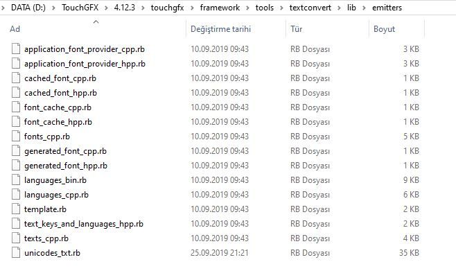

2019-11-07 12:16 AM
Folder is exist but there is no "typed_text_database_hpp" in the folder like the said error. I add a screenshot of folder.
