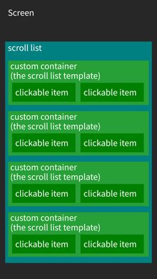

1. I have a scroll list of custom containers which contain several clickable items. Drag events on the scroll list are intercepted by the touch areas of the clickable items. This makes the scroll list difficult to scroll as you have to hit the tiny spaces in between the clickables for the drag event to register.
I saw two posts on this forum regarding a similar problem:
The accepted answers in both of them did not fix my problem as my application does not allow me to override the touch handling on the view level. The answer given by @GMeur in thread 2 was closer to what i was looking for but only works for me when the scroll list template object itself is clickable. In my case only the children of the template object are clickable. As I do not understand when, how and why touch events are propagated from one drawable to its children/parents, I was not able to solve this problem generically (without having to manually wire a ton of touch event callbacks manually for every widget with which I have this issue).

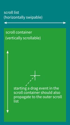

2. I have a horizontally scrolling scroll list which contains a container template with a vertically scrolling scrollable container. I want to be able to swipe the horizontal scroll list even when hitting the touch area of the scrollable container.
This is possible when using two nested scrollable containers but not with scroll list + scroll containers.
