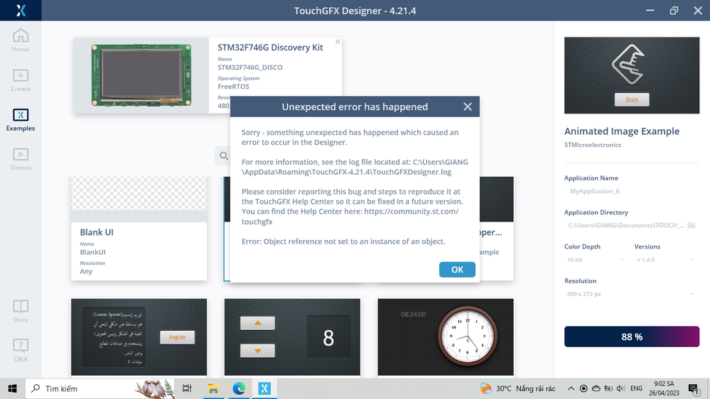

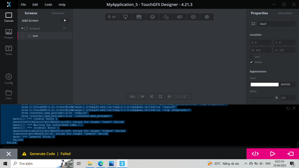

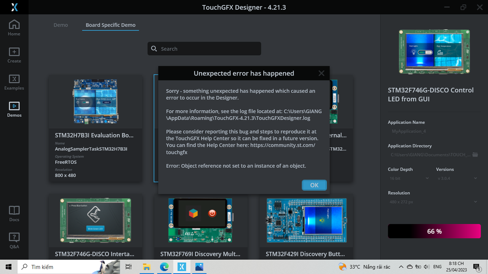

i am having problem when i try to use demo or create a project, these errors keep repeating even when i restart the app i have uninstalled 4.21.3 and installed the latest version but it keeps crashing.
Did I skip any steps during code generation or initial setup?

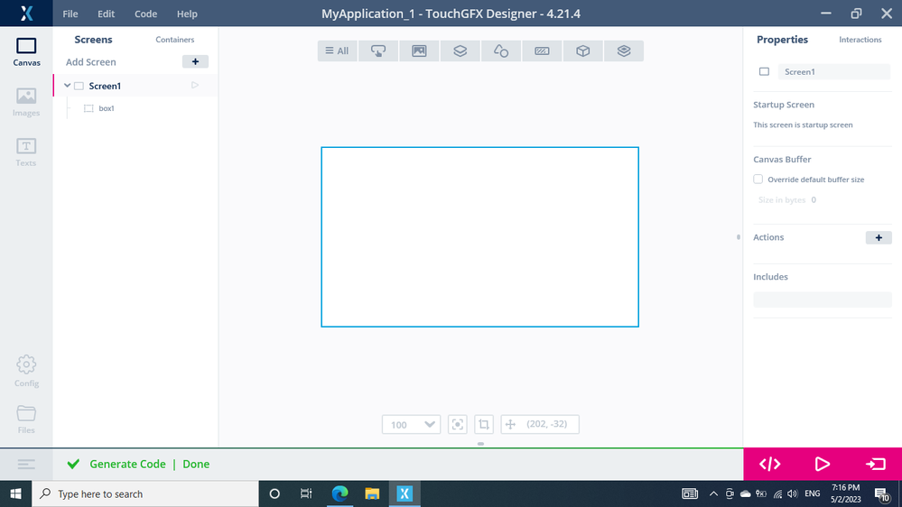

ok touchgfx worked, after the 2nd reinstall of windows, maybe it's not very friendly with local languages, hopefully in the future i can use it in vietnamese, my approach seems a bit waste time. hope others have a better way of doing it.
this is how i made touch work properly
-reinstall windows with default language and default keyboard(united kingdom), don't edit anything.
- the initial microsoft account login seems to affect it too. (or because i have a vietnamese account).
in the end i want someone with a better solution than me, reinstalling windows is quite time consuming...

Hello OWLchan,
Could you send us your log when you reproduce the issue? The file is located at : C:\Users\YOUR_USE_NAME\AppData\Roaming\TouchGFX-4.21.4\TouchGFXDesigner
/Osman

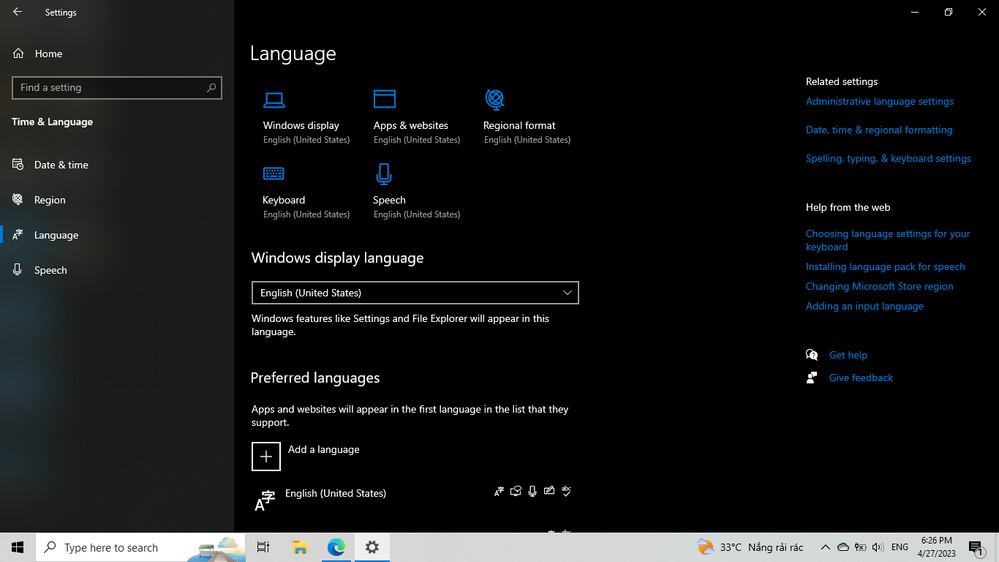

Hello OWLchan,
There's apparently an issue with your environment. Does your Windows is in Vietnamese? I can see that the Windows-1258 code format has been tried to be used but the ruby code converter doesn't support it (Encoding::ConverterNotFoundError in the logs).
My best guess would be to try to switch to an English-based Windows machine and see if the issue is still there.
/Osman
2023-04-27 4:35 AM - edited 2023-11-20 7:08 AM
yes i use local language on my pc, and i have also seen some people have problem with the previous language ( turkish ) So i tried changing the language yesterday and installed reset the app, it still doesn't work. maybe I'll try reinstalling my own version of windows. I will be back soon.

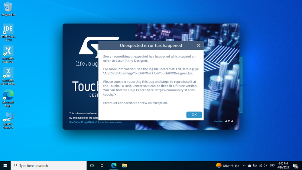

2023-04-30 4:10 AM - edited 2023-11-20 7:08 AM
2023-05-01 6:44 AM
Hello @OWLchan,
Sorry for the inconvenience, that should not happen.
Did you already try to uninstall and re-install TouchGFX 4.21.4 ?
/Yoann
2023-05-02 5:32 AM - edited 2023-11-20 7:08 AM
Thanks everyone for the support.
2023-05-02 5:35 AM
I reinstalled windows too, and it worked.
thanks :3333
