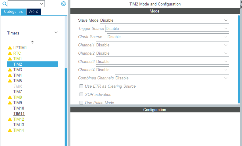

When I enable TouchGfx in Middleware->Graphics the Timer2 is being disabled (in ParameterSettings->TimerInstrumentation I select Timer14). Is there a connection between those two or it is a kind of bug I can fix manually in code?

2019-09-18 11:26 AM
Yes, I meant the MX project form CubeIDE
STM32CubeIDE - Version: 1.0.2 Build: 3566_20190716-0927 (UTC)
STM32CubeMX - Version: 5.3.0.201907110903
I created new STM32 Project - all the peripherals were initialized as default (STM32F746NG DISCO). Timer2 is being disabled when I enable the TouchGfx

HI @kajoje123 ,
Thanks for ypur feedback, this bug has been already fixed and it will be available for the next release -5.4.0-
